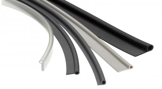

I used a "P" shape weather stripping from a local hardware store. Gently pry the cowl up, and insert the thin part of the rubber strip. Then You just push it in the whole distance.
No popping for 2 years now.
