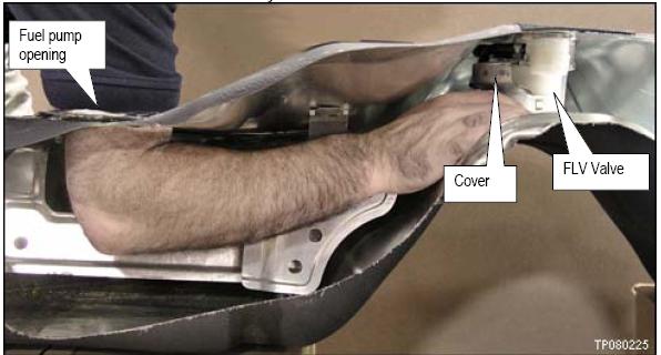

technical service bulletin
got the TSB from over at infinitihelp.com
FE08-004a ITB08-041a October 28, 2008
HARD TO FILL FUEL TANK
Applied Vehicles has been amended and the Classification was changed to FE. No other content has changed. Please discard all earlier versions.
APPLIED VEHICLES: 2003 – 2006 G35 Sedan (V35)
2007 – 2008 G35 Sedan (V36)
2003 – 2007 G35 Coupe (CV35)
2008 G37 Coupe (CV36)
2006 – 2008 M (Y50)
IF YOU CONFIRM
The fuel tank is difficult to fill more than ½,
NOTE: Filling nozzle continues to click OFF when the fuel tank is more than ½ full.
ACTIONS
Install the Cut Bracket (cover) onto the Fill Limit Vent Valve (FLVV) inside the fuel tank (see Service
Procedure).
NOTE: All fuel must be removed from the tank for this procedure.
Attachment 79665

gas tank cutaway from tsb
try not to leave any blood in the gas tank after being cut by the sheet metal?
