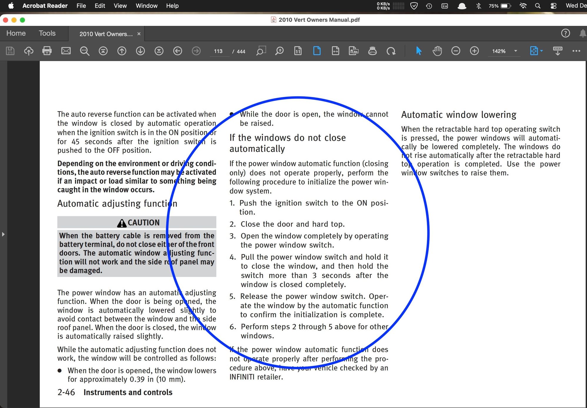

Thank you so much that stopped the beeping and took the red light off the dash but now my driver's side and passenger side windows crack open when I initially unlock my car. I am thinking maybe I will try to retract the roof one more time and see if it re-sets? When you said in your instructions " door switch off", I am not sure what switch you are referring to?
Just make sure both doors are fully closed. Everything is in the owners manual which, if your car didn't come with one, can easily be found online. From said manual:
