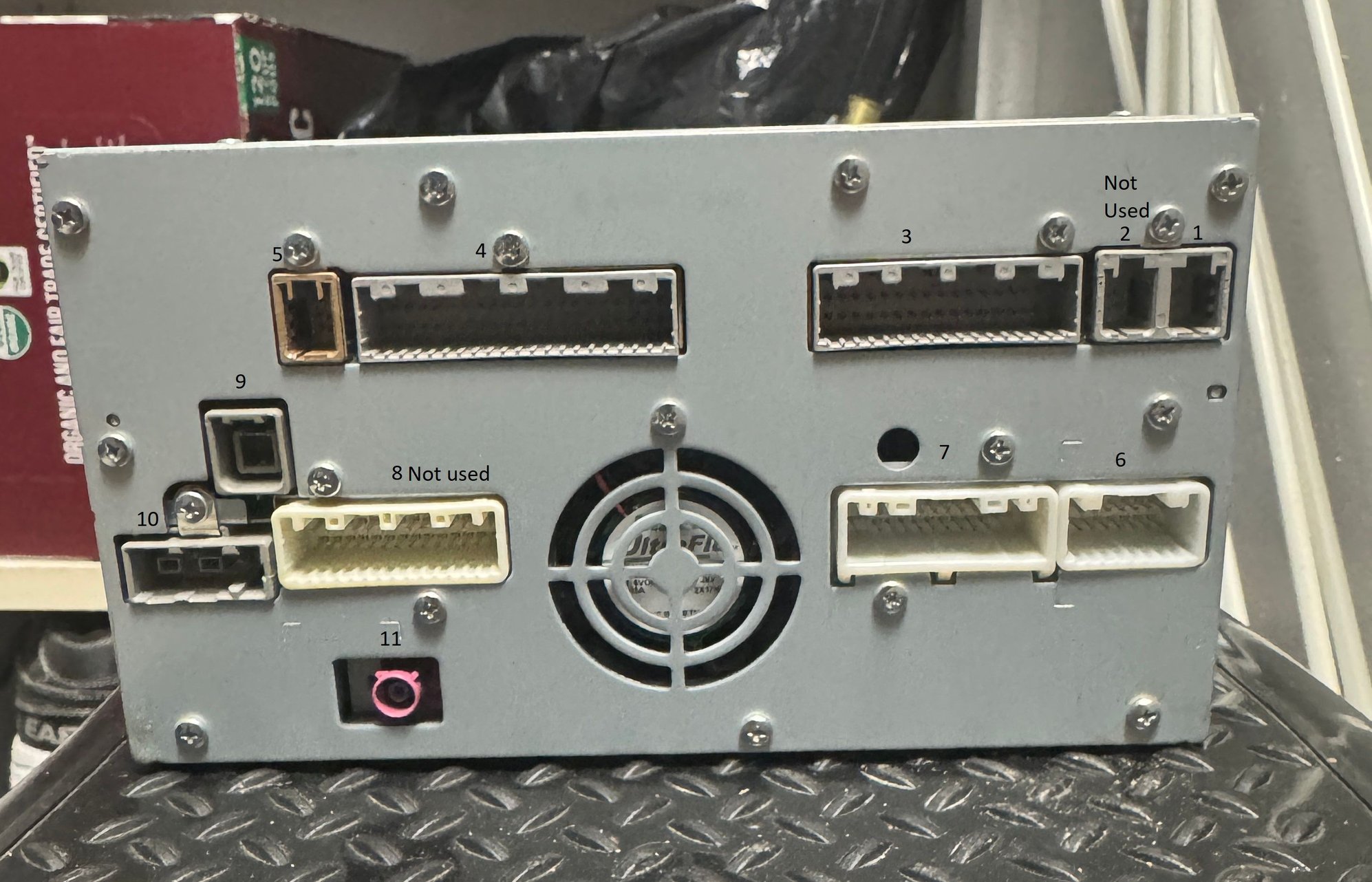

By chance does anyone have a rearview wiring diagram of the radio DVD CD player?
I am especially interested in items marked 1 and 8 not used.
All help would be greatly appreciated!!

These headunits were used in just about every Nissan/ Infiniti from 2008-2015 +/-. What vehicle and specifically what packages were "offered" determined how the headunit was configured at the factory.
The #1 (your pic) is for the USB inputs- front and rear. I "believe" the rear USB was for those non-G models that had the headrest monitors (FX maybe?) but I am not 100% certain on that.
The "#8" (your pic) is for the Bose "Studio on Wheels" (or whatever marketing tagline Infiniti used) 5.1 channel audio system that was offered on the M's and later Q/QX models.

Thank you, very much appreciated! I wonder if number 2 can be used for USB instead of number 1.
I am experiencing intermittent usb going over bumps. I am wondering if it is the jack for number 1. If so, I am hoping that using jack number 2 might solve the problem. This all assumes that the problem is not the connection from the jacks to the board.

Likely the port in the center console has issues? These can be problematic from time to time. I've had to replace mine before...

Do you know if both usb ports are active and can either usb port be used?

Being they are solely inputs I would imagine both are "active." However, I just do not know for certainty if the head unit will "recognize" or "differentiate" one from the other.
