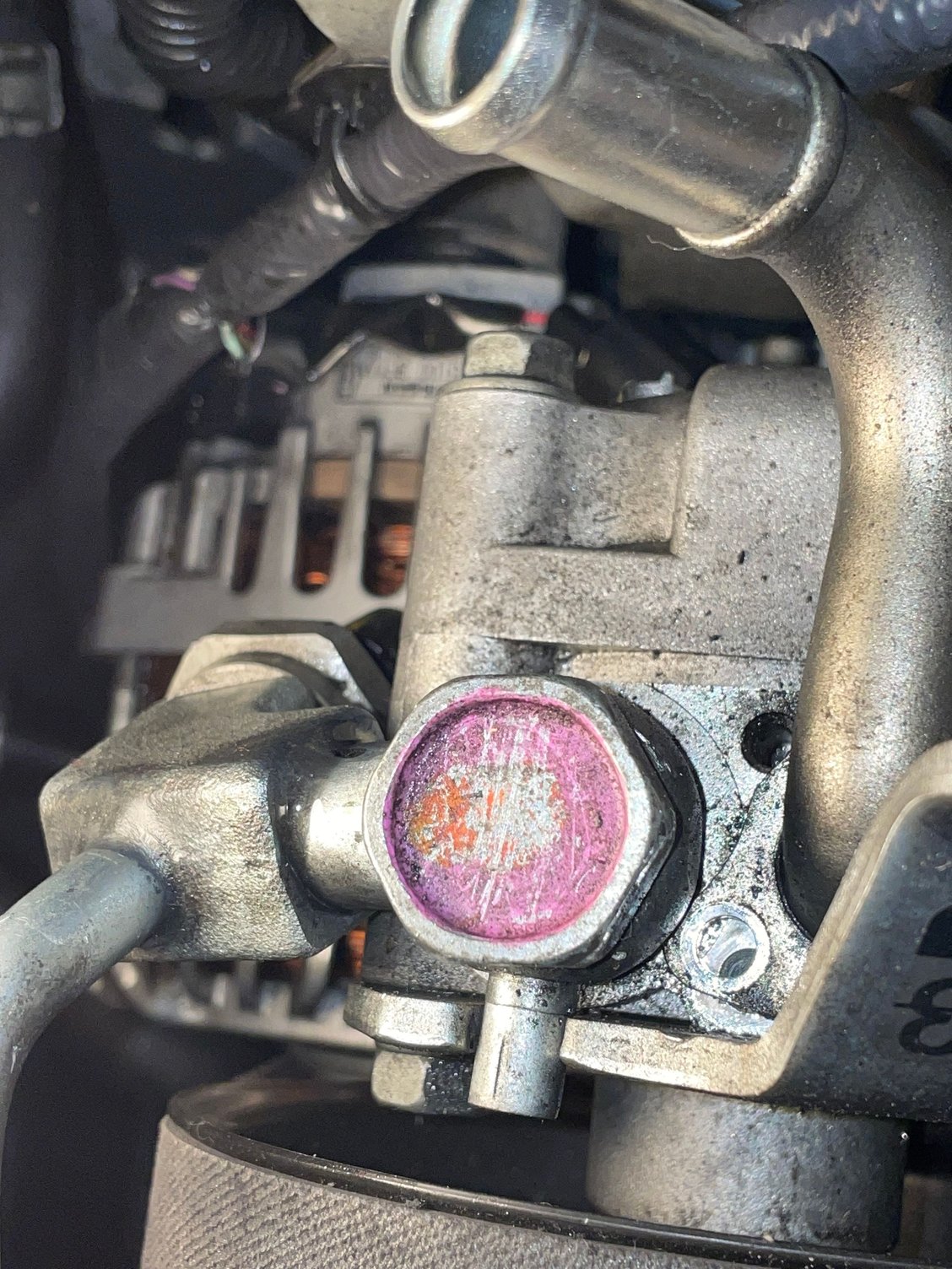

So my sensor started leaking after a crash I got a new one but I’m not able to take off the bolt due to there not being enough space to put the 27mm wrench or socket in, any advice ?

Either Spend $50 in a 27mm "crows foot" and a few wobbly extensions
or
remove the banjo bolt, make a mess of PS fluid, bring up the line a bit, secure the line and finally used the 27mm wrench you already have.
You'll be making a mess regardless, once the PS pressure sensor comes off it will start leaking. You'll have a bit more control removing the line from the pump.
Good luck.

good part is there’s 0 fluid left from the leak lol
