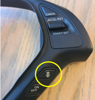

Does your car have the "Intelligent Cruise Control" (ICC) or the standard, fixed speed system. In other words, do you have this button:
If so, there is a distance sensor under the front, driver-side bumper that can get dirty and cause the cruise control to not set.
If not, then the issue gets tricky to diagnose.
