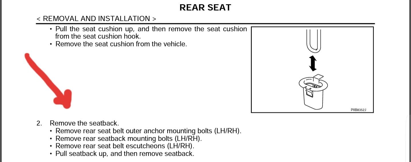

Not sure how helpful this will be, but the following is from the 2010 factory manual:
It appears there are just two (2) nuts on top and two (2) bolts on the bottom. Once removed the seatback gets lifted up and out.
You can download the manual for your car here. Section SE is for the seats.

OK....turns out to be a LOT easier then I expected.
It's just the 2 bottom bolts ILM-NC G37S showed above (not the nuts) and push up....a lot. The roll bar cover some up with the seat back so you have to lift fairly high to get them over and off the roll bars. (be careful not to damage speakers when maneuvering both the back and bottom of the seat)
This will allow you to pull the seat back forward to work behind the back. If you need to remove the back completely from the car, you need to also:
  1. Remove the seatbelt escutcheons (plastic piece surrounding the seatbelt where it goes through the top side of the back of the seat)
  2. Bolt holding bottom of belt to floor
  3. Feed belt and escutcheon through hole in the seat where seatbelt goes through seat.
  4. Remove seatback from car
Thanks again ILM-NC G37S!

Reinstallation tip:
Bolts at bottom of seat back are meant to be installed a little loose to allow the back to slide up during installation of seat bottom and back down when bottom is installed.
