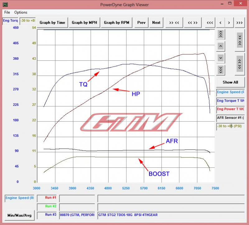

Here are the results from our new low reading Mustang dyno testing of the 18g's on the 370Z.
Stock 91 octane
271.2 RWHP (289.1 Dynojet equivalent)
224.3 RWTQ
8psi 91 octane
395.9 RWHP (422.1 Dynojet equivalent)
351.1 RWTQ
(46% more than stock)Name:  GTM8PSIHPANDTORQUEWITHBOOST-2copy_zps0ee641da.jpg

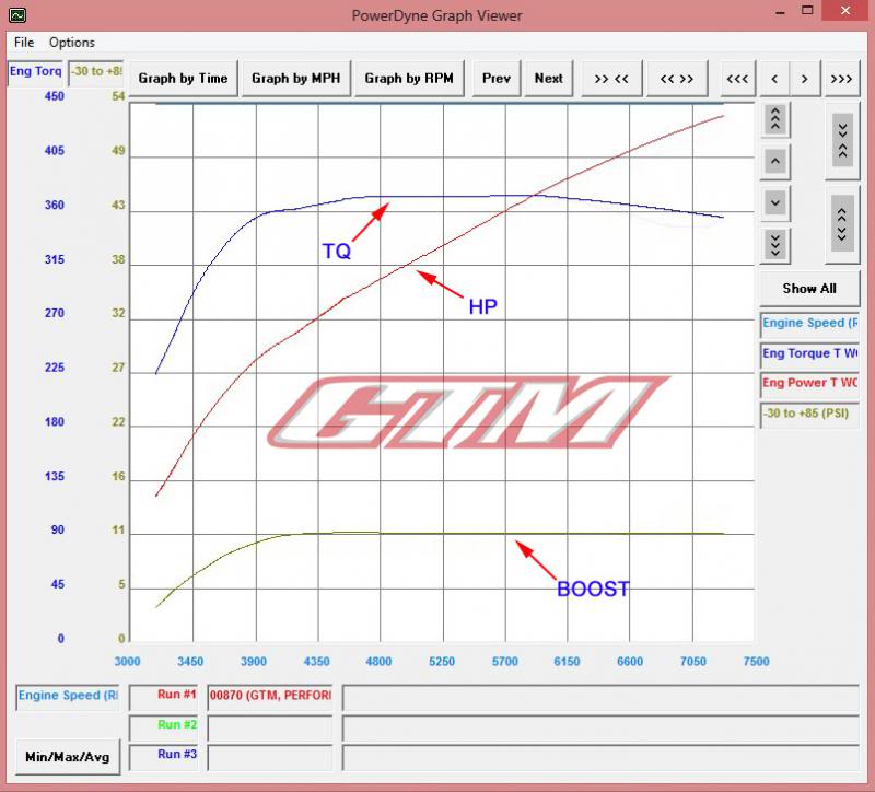

11psi 91 octane
494.4 RWHP (527.1 Dynojet equivalent)
395.9 RWTQ
(82% more than stock)

On dynojet:The 16g kit produces 440.7 hp and 422 wtq at 10psi with a stock exhaust on a ipl...(alittle bigger than regular exhaust on g)On Mustang dyno: 18g kit made 494.4 hp (527.1 dyno jet equivalent) and 393.9 rwtq at 11psi with a stock exhaust.
Things to rememeber.
1. 16g is more like a stock turbo car. Boost instantly and sam says you have 4 psi of boost at 2200 rpm so hard to keep it out of boost if you drive on the highway alot.
2. 18g looks like boost comes on around 3000 to 3200 range.
3. The added trq on the 16g goes away once you open up the exhaust more but your hp climbs magnificently.
Both are great options depending on your driving habits, location and what your using it for.
