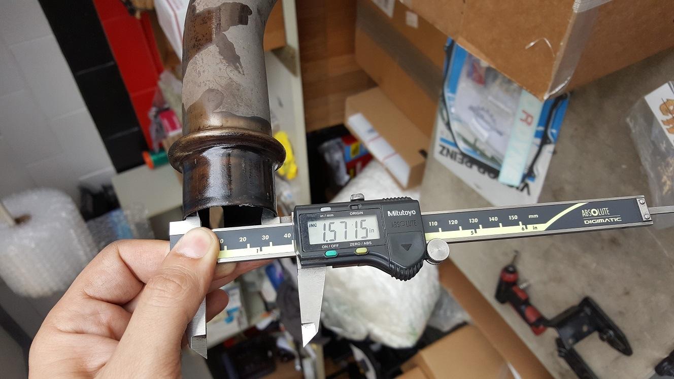

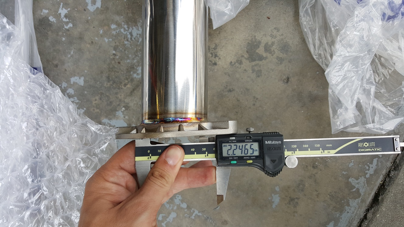

The good: Invidia has a pretty quality built exhaust, and I was overall very satisfied with fit and finish, although there was a problem with the fitment of the tips. My guess is that at some point they changed the diameter of the piping, because the website mentioned 60mm pipe, but in reality it's 2.25 inch inside diameter, therefore tips were for bigger pipe, and required a trip to muffler shop to have them welded in. The rest of the piping is pretty good, nice smooth bends, clean welds, nothing to complain about. The exhaust is definitely on the quiet side. At idle it only registered 63 DBs (57 DBs stock) and at wide open the meter peaked at 89 DBs (87 DBs stock). During the daily drive, it's barely noticeable, which is actually great because I didn't want a loud exhaust or something that would annoy me daily.

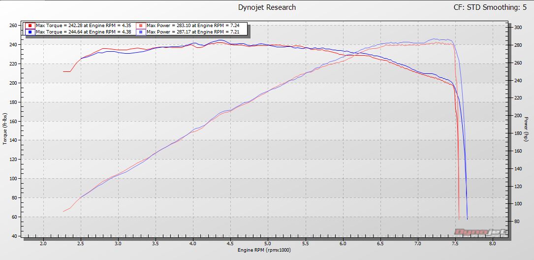

The not so good: This exhaust is heavier than OEM catback. OEM complete system was around 61 lbs, while complete Invidia kit is around 73 lbs, so total gain of 12 lbs over stock. The power isn't terribly impressive either. While it is a substantial step up in pipe diameter, particularly in the rear section where it goes from 1.5 to 2.25 inch diameter, the chambered muffler slows down the flow of the exhaust, and therefore on the dyno it only picked up 4 rwhp at the peak. Most of the power difference was up on top, above 5500 rpm.
Test conditions: All the testing was done on the same day roughly 1 hour apart from each other. All pulls were done on DynoJet dynamometer, in 4th gear due to top speed limiter restriction. In 5th gear (a true 1:1 gear test) the car was making 5% more, so you do the math. Before people start chiming in how this requires a retune to fully optimize the catback, the tuning is not actually required. The Air to Fuel Ratio was the same between two runs, nothing else is changed. The tuning that you would do on a catback would affect stock setup in the same exact way.

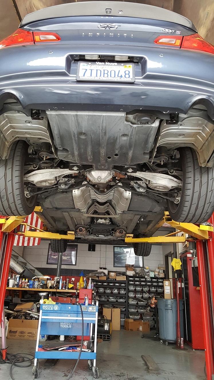

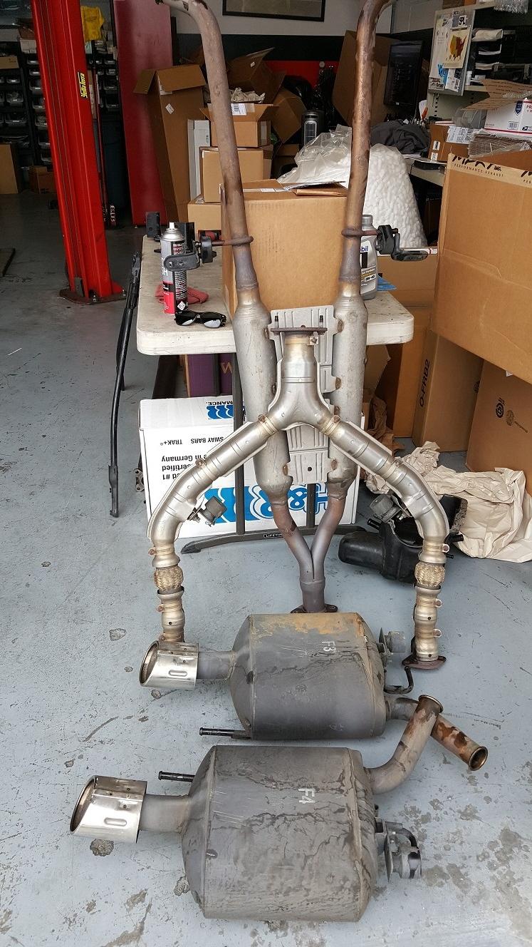

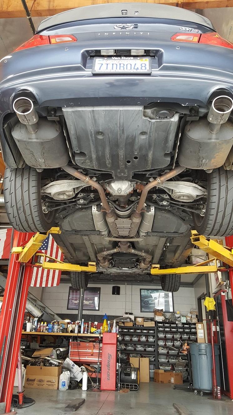

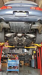

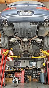

Stock Exhaust.
Stock pipe diameter vs Invidia pipe diameter

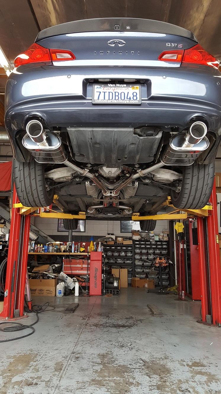

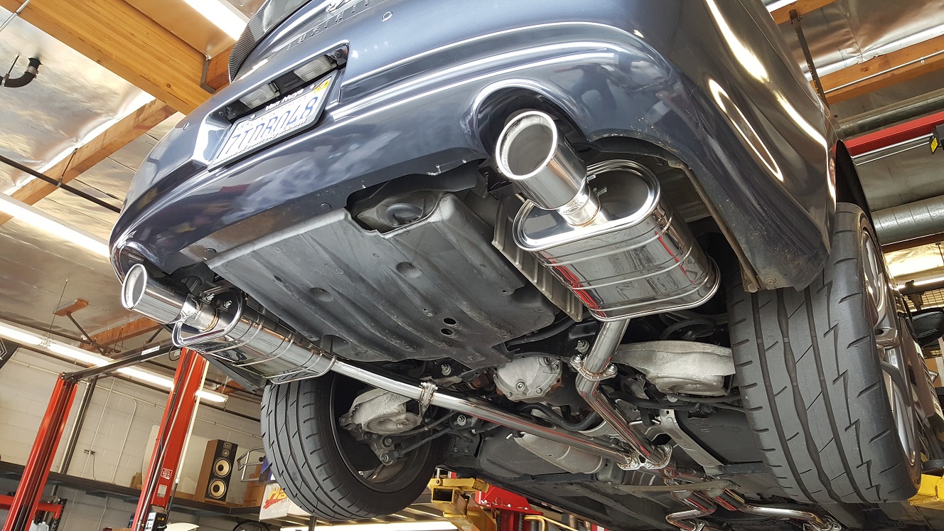

Invidia Q300 Installed
Dyno Comparison
