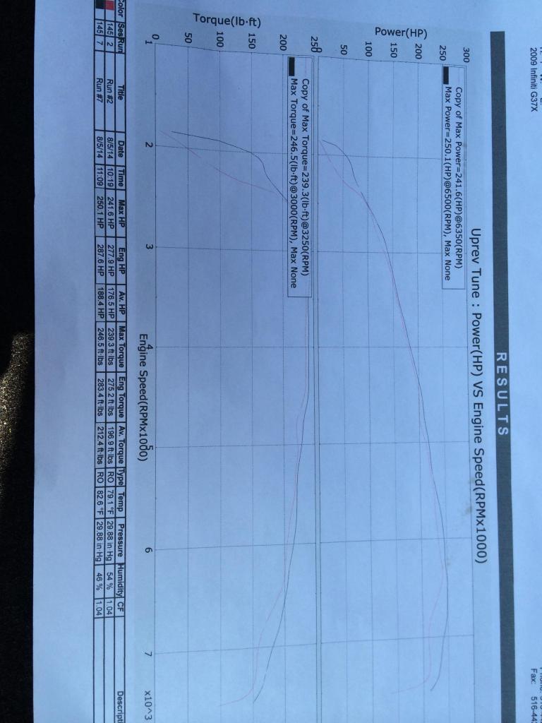

Anyone else think this seems a bit low? Mods are R2c, Berk cats and Ark exhaust..
Kinda disappointed with the numbers but the car seems faster after the tune. Not sure whats up. Maybe go get a second opinion somewhere else?
I know all dynos will read different, this particular one is off a dynocom.

Thank you.. Real auto dynamics in oceanside, long island. Little concerned with the numbers but I love the way the car drives post tune.

It's low cause he stopped 1500 RPMS SHORT ! the dyno should have been run to 7800?
Why'd they stop at 6300? That makes no sense.

How did they stop at 6300? The graph clearly goes past 7k, max power was made at 6300 on run 1 before the tune.
I'm actually not too concerned because a fully bolted 370z with meisterschaft exhaust only put down 260 according to their dyno, maybe it just reads low.

I wouldn't worry to much about it. Probably just a stingy dyno.
