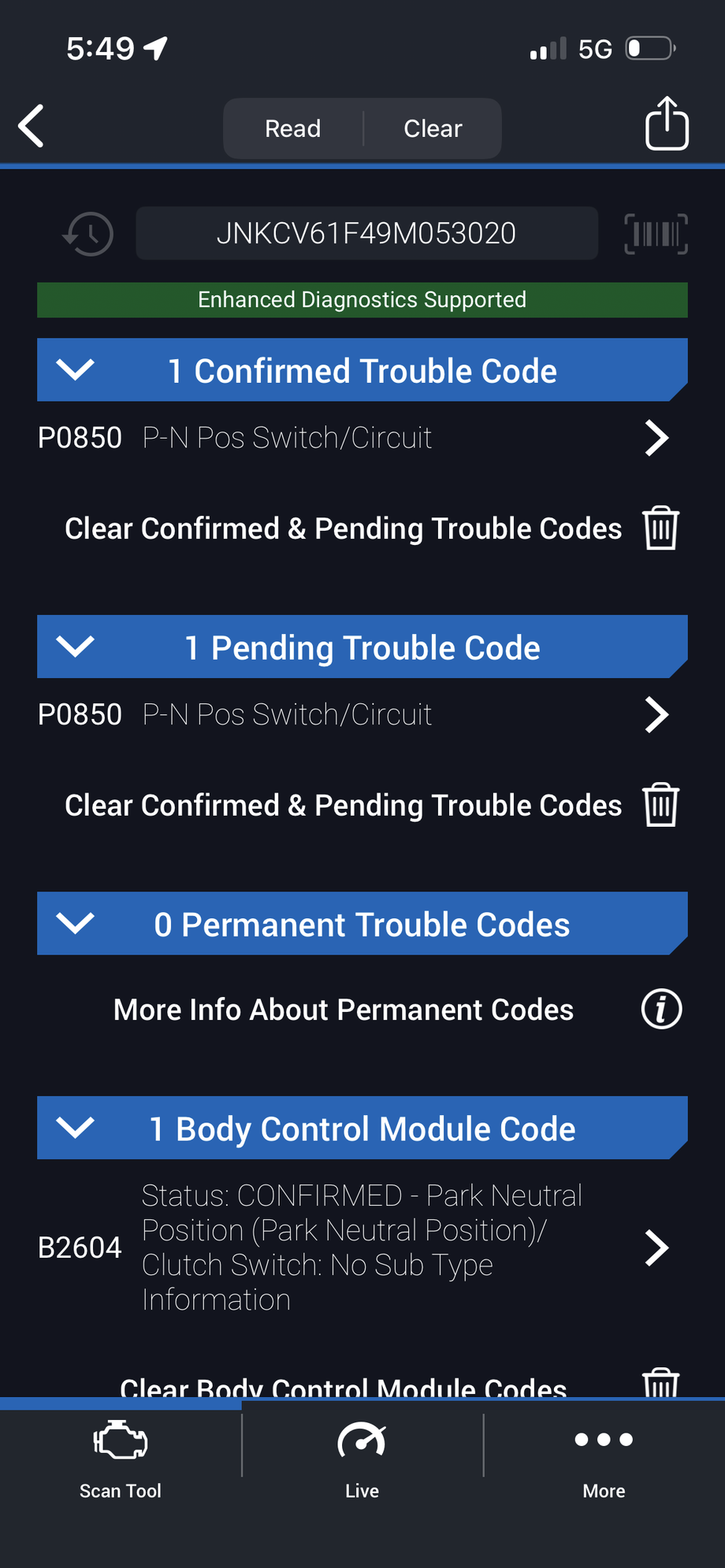

Two “key” error codes.
P0850 and B2604
P0850 and B2604

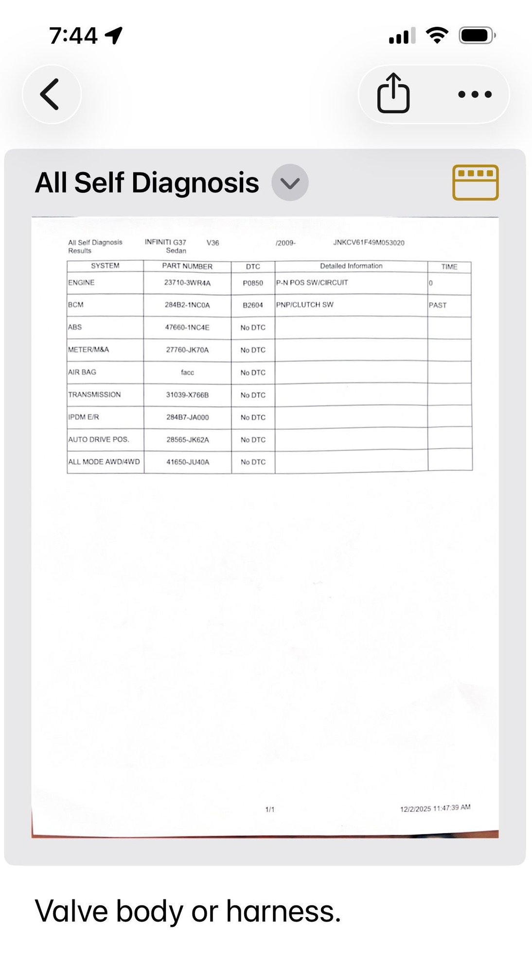

Is that printout from the Infiniti dealership?
Then more than likely the issue lies in the TCM. Nothing you can do about it short of replacing the transmission or the TCM as the PNP sensor is not user-serviceable on the 7AT.
Maybe others will have other ideas/ thoughts, but if the center shifter didn't resolve the P0850 and assuming the shift rod is properly adjusted (B2604) then it has be a internal fault within the TCM. Harness issue, while possible, is exceedingly rare for these codes.

Printout
Yes. That is the printout from the Infiniti dealer in Thousand Oaks CA.
