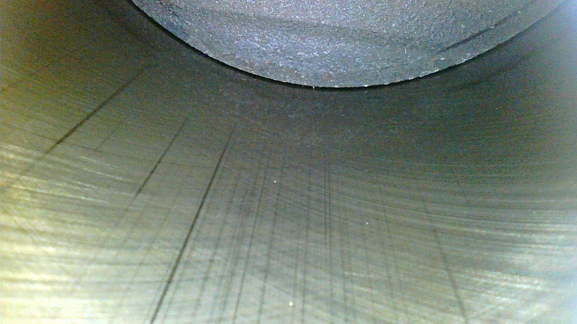

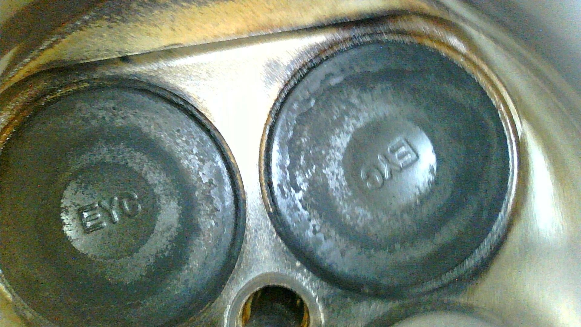

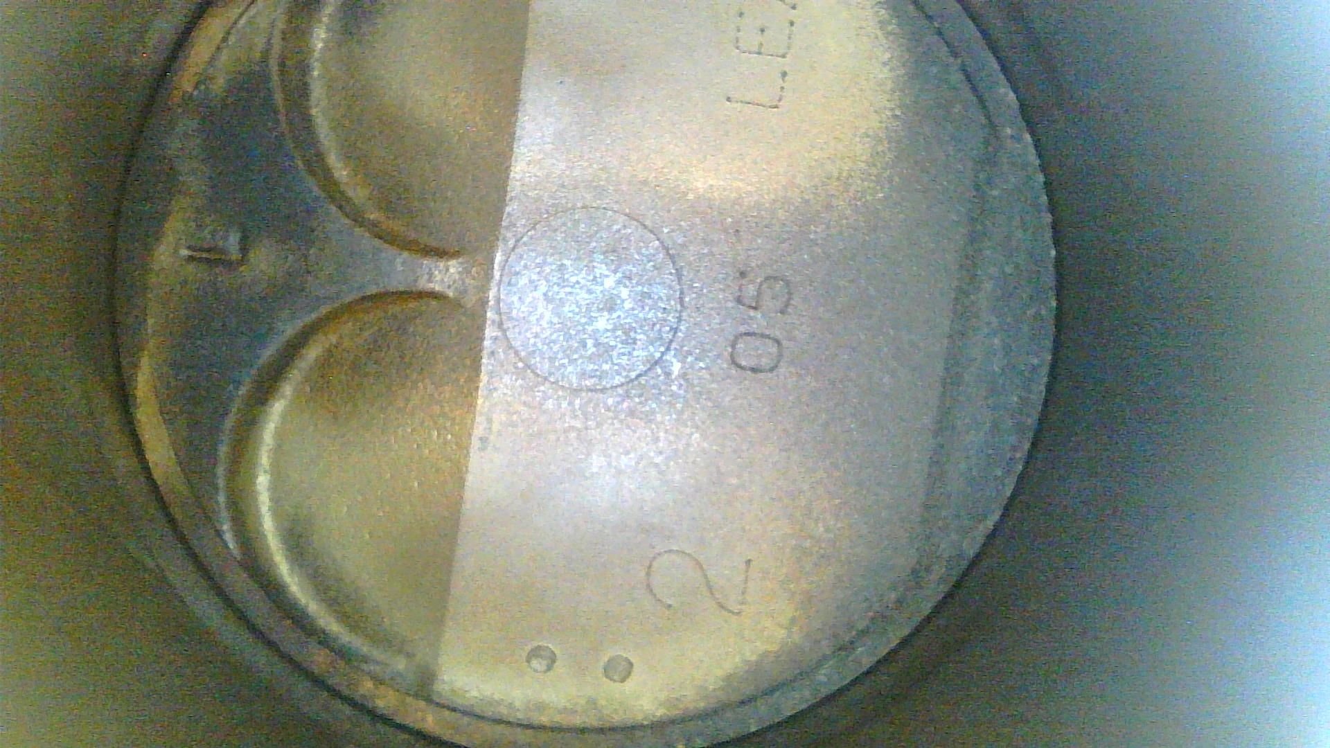

I want to bring community awareness, that low quality high flow cats are bad and most likely will cause engine damage. Most aftermarket ones are metal core catalytic converters. When they fail, small metal pieces will be sucked in to the cylinders (usually on WOT), this is where first damage occurs.
It will scratch cylinder walls, some of the debris will exit trough exhaust valves back to exhaust and some of it will be scraped to oil pan. This is were secondary damage will occur. Leftover pieces will be sucked in throughout oil pump. Again, oil pump will suffer some scoring.
And all destruction don't end there. Right after pump, there is an oil filter, in perfect it should catch all abrasive material. But we all know there are situations when bypass valve is open, so all the garbage travels throughout bearings, crankshaft, camshaft...(did couple oil lab test, iron and aluminum levels were elevated)

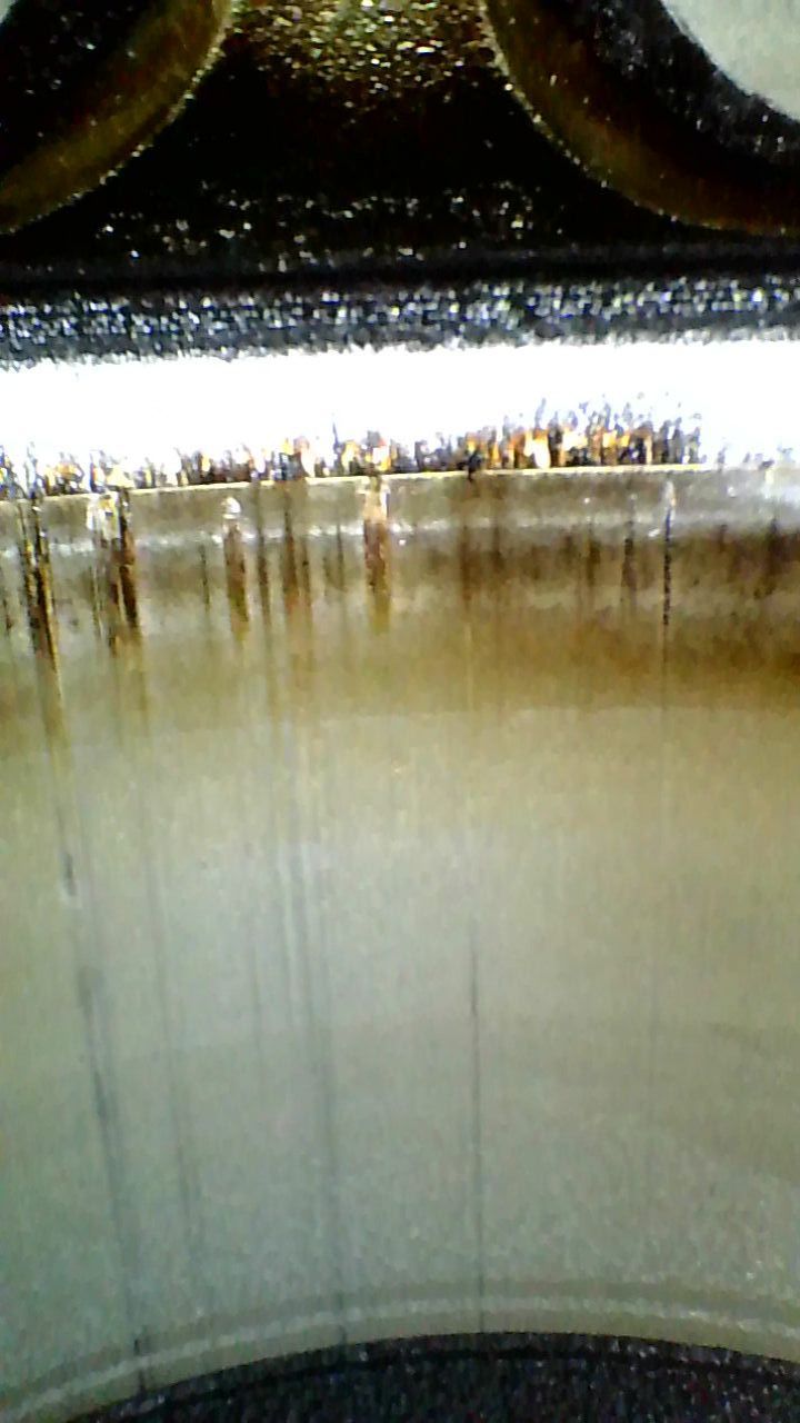

Vertical lines is the damaged caused by the CAT failure.
45k on the engine, very little carbon buildup

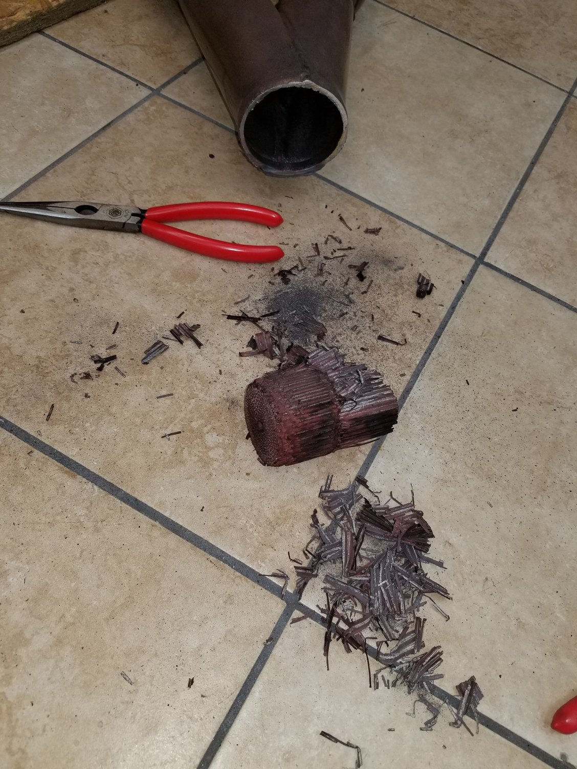

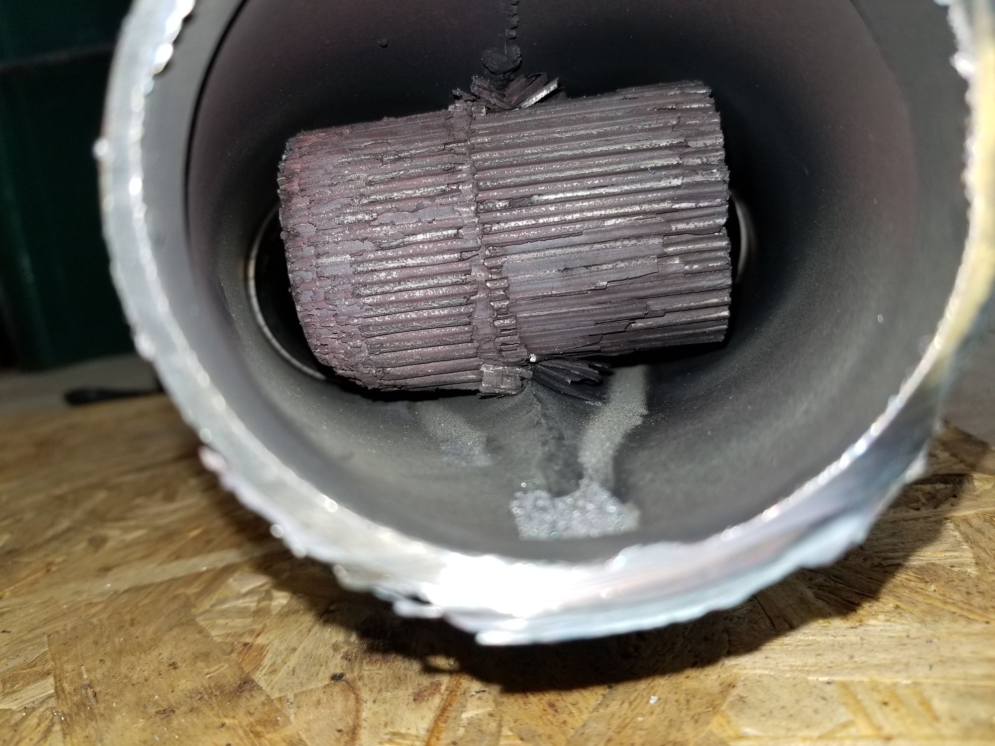

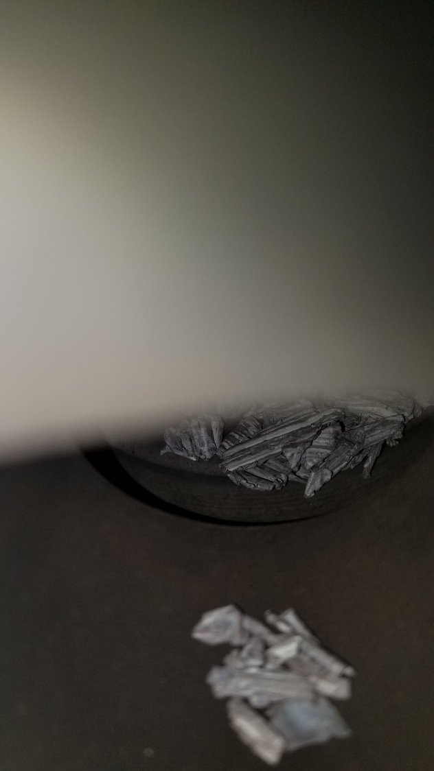

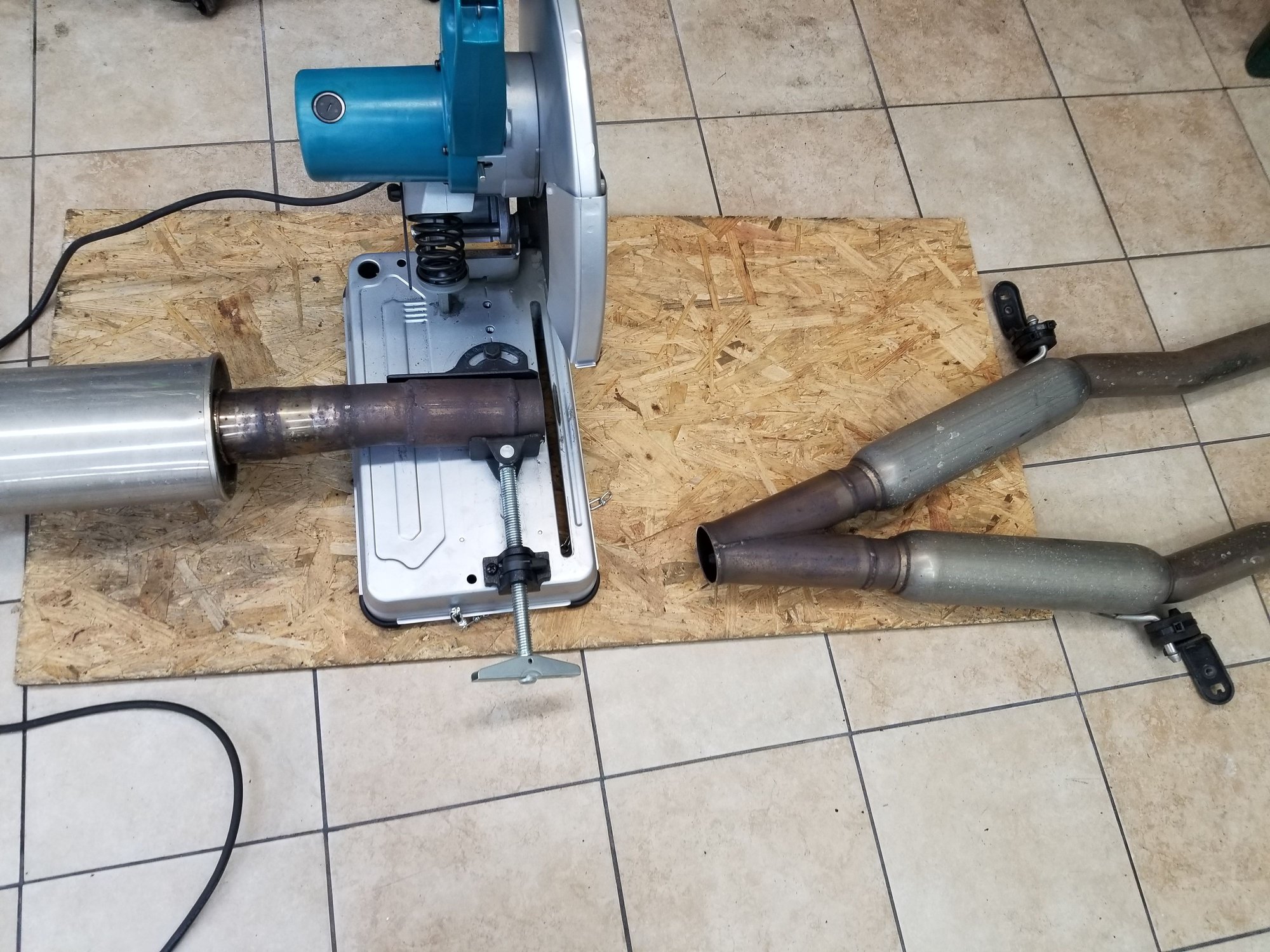

Had to open mid pipe to retrieve leftover CAT
Another one bites the dust
All these small pieces can be sucked in to the combustion chamber

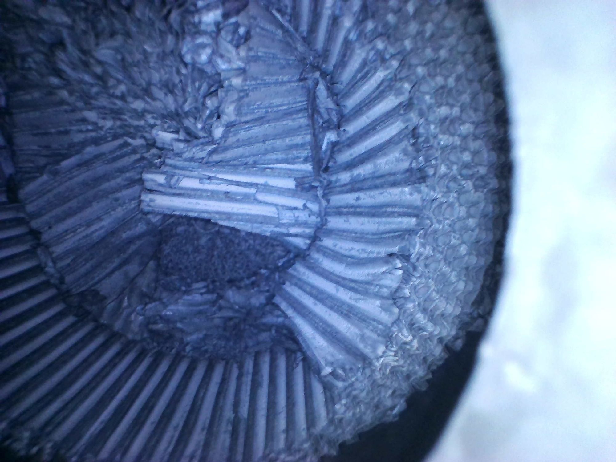

beginning to fail

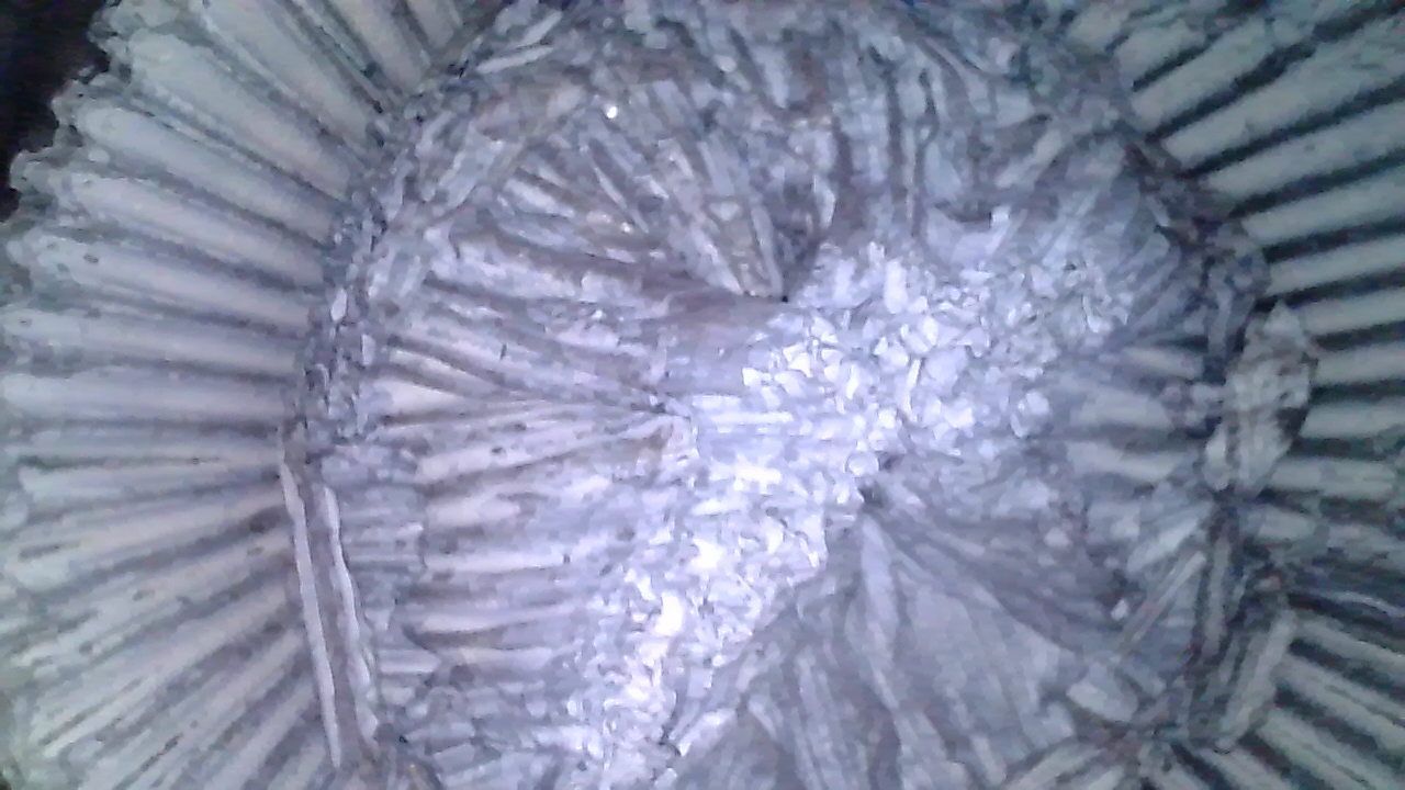

Completely failed
Completely failed
Completely failed
Cat failed but sensor was still reading "ok", no CEL on Acura
More vertical damage lines on Acura engine with Nikasil cylinder bores

This is extremely interesting. You did a fantastic job at documentation.
My initial thoughts were the Acura's position of the EGR hole could have brought this debris in VS the VQ since the cats are positioned lower on the VQ vs the Acura.
That bore scope shows those scratches and based off on what I've seen come from you, you seem to know your stuff.
I believe that the ingestion of these particles don't happen under normal operation but under clogged operation when the exhaust pressure is doing all it can to exit and it can't efficiently then it can travel back into the cylinder since for a moment there would be more pressure in the exhaust than in the cylinder as these forces are trying to escape. At this point most of these failures would compromise AF/O2 sensors but not all.

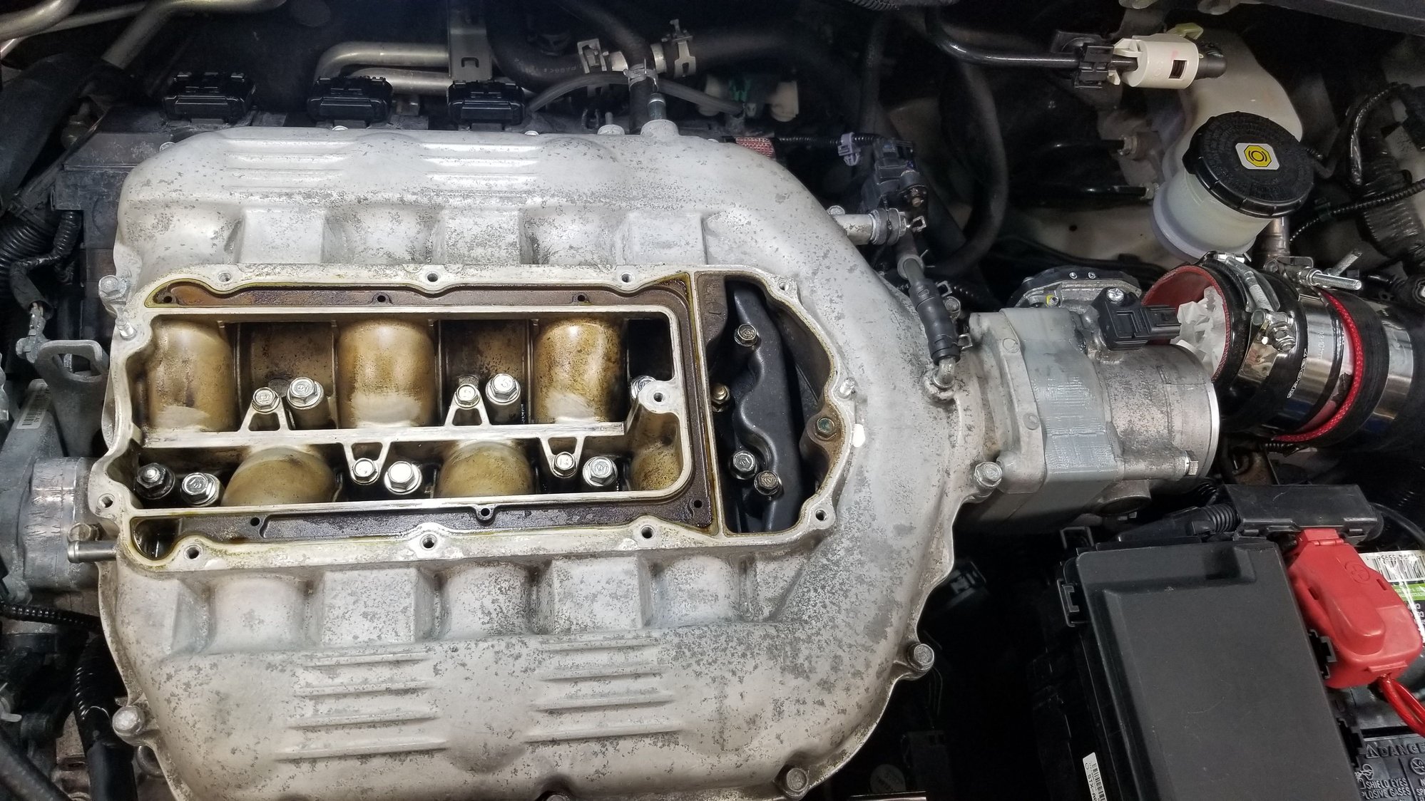

Picture of exhaust gas feed holes:
Also on VQ it is hard to tell when cat fails, I did not have lights, rattles. With such a huge restriction I could not feel any power loss. I sent my logs to tuner, because i was suspicious and asked him if he sees anything out of ordinary. His response was log's look great.
I have seen ceramic CATS failures on Hyundai I-4 engines. Damaged was much worse and only about 50% of CAT surface area was compromised. It looked like somebody pored sand in to the cylinders...
