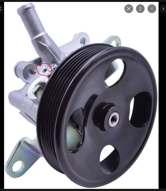

Bull, thanks for the write-up. When fixing my water pump, i've noticed my p/s pump had a leak. Appears to be coming from this hole on the left of the reservoir suction line. Is this like a weeping hole on the water pump? lol

Care to show more pictures? There should'nt be a hole in that location unless it's an aftermarket pump it's possible a bolt was put through and broke through the pump body.
Another possibility is that this is a sports pump with base pump attachments.

See below. I've circled the hole on the stock brand new pump below. I, too, thought that someone was there before me and put the wrong bracket on it, but this appears to be some kind of a "feature" on these.

Seems like a maxed out bolt.

Just taking a stab in the dark, but being that these pumps are used on practically all Nissan models, is it possible the hose on some models gets rotated 180º and the retaining bolt uses that location? Like this:
Again, just venturing a guess. Either way, there is no "weep hole" for the PS pump. If fluid is leaking from that spot, then there is a internal failure to the pump.
Do you have a similar sized bolt that will fit? Temporarily, you could thread a bolt in there and have it act as a plug. Not a fancy fix, but it should suffice in a pinch until you get a replacement pump.

what do you mean by "maxed out bolt"?
if you look at the picture of the brand new pump i've posted, it also has the same uncovered hole. i don't think it's even threaded, but i'll take another look at it today.

That should be a blind hole or a threaded for maybe other chassis.
If its coming out of this hole it means someone tried using this hole and tightened the bolt past the end of the hole which opens the hole into the pump body.

confirmed it's not threaded. went ahead and plugged it up with some epoxy putty. new (to me) pump on the way and should be here by the weekend ($25 shipped 70k). i also scored a 70k rack for a '12 sedan for $70 shipped (sans tie rods) off ebay also. i found your thread where you said all the V36 racks are basically the same except for the different tie rod ends. we'll see when she gets here. thanks again!

Make sure you clean the hole well and epoxy will do it. It is very possible that this leak is not really coming from this hole but from the gasket of the return neck and making it look like it's the hole.

yeah, you were right, it was leaking from the suction pipe's o-ring. little bastard was hard to buy, as no one had it around town. part# 49162-6C900
o-ring disintegrated and broke apart when taking it off...

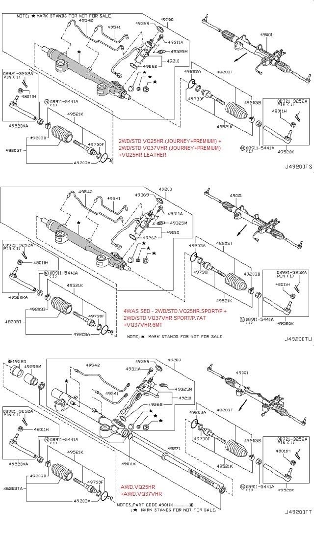

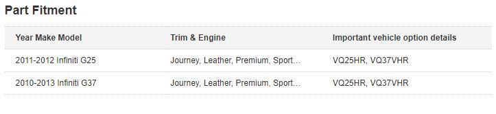

2012 rack came in. see below for the numbers it had on it:

Old Oct 10, 2022 | 11:09 AM
BULL's Avatar
BULL
Moderador
Joined: Jun 2019
Posts: 2,626
Likes: 764
From: South Florida
49001 - JL07A - coupe 4was
49001 - JL06A - coupe base
49001 - JK600 - RWD sedan base
​​​​​​​49001 - JK60A - RWD sedan base
​​​​​​​49001 - JK60C - RWD sedan sport
49001 - JK63A - RWD sedan base
​​​​​​​49001 - JK620 - RWD sedan 4was
​​​​​​​49001 - JK62A - RWD sedan 4was
49001 - JK62C - RWD sedan 4was
49001 - JL06ATJ - RWD base -2008
Diagram (1 of 1): 4WAS SED - 2WD/STD.VQ25HR.SPORT/P +2WD/STD.VQ37VHR.SPORT/P.7AT +VQ37VHR.6MT"
The diagrams list 3 different images for racks for the V36
RWD, 4WAS, AWD
If you pay attention to the diagrams you'll see in the bare rack the part numbers are the same, only one that changes shape and number is the AWD one
