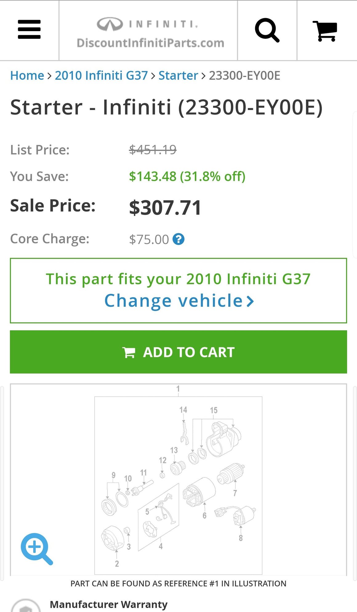

Originally Posted by slovell1
A starter from O'Reily, Autozone, Advance is $416.00 plus core.
That's abso-frickin-lutely outrageous. You can get a BRAND NEW starter from Infiniti for $300!
Post a link. Cheapest I could find is $341.28 (without shipping) from infinitipartsdealer.com and that includes the core charge.

https://www.discountinfinitiparts.co...MtN2wtdjYtZ2Fz
Quoted as of 28 July 2019.
I would never pay over $400 for a remanufactured starter, especially from those crap chain stores. Just my opinion....

Yeah found that one. Still not $300. After shipping/core charge/returning core and paying for shipping it back it's still going to be around $340-$350.
LKQ it is.
