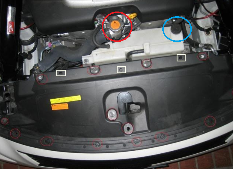

Originally Posted by venkatasai1989
I restarted the car again now(the weather is sunny at present) and the the idle was smooth and no smoke or water was observed from the exhaust. I let the car run for a minute or so and then pushed the accelerator hard couple of times. i then observed light white smoke from the exhaust and also little water from the exhaust. after few seconds, the white smoke disappeared tho.
Red circle = radiator cap
Blue circle = reservoir cap
What is the level under the cap circled in red?
the level under the red cap is full. when I opened the cap, the coolant is till to the top and with no oil residue nor any air bubbles observed.
