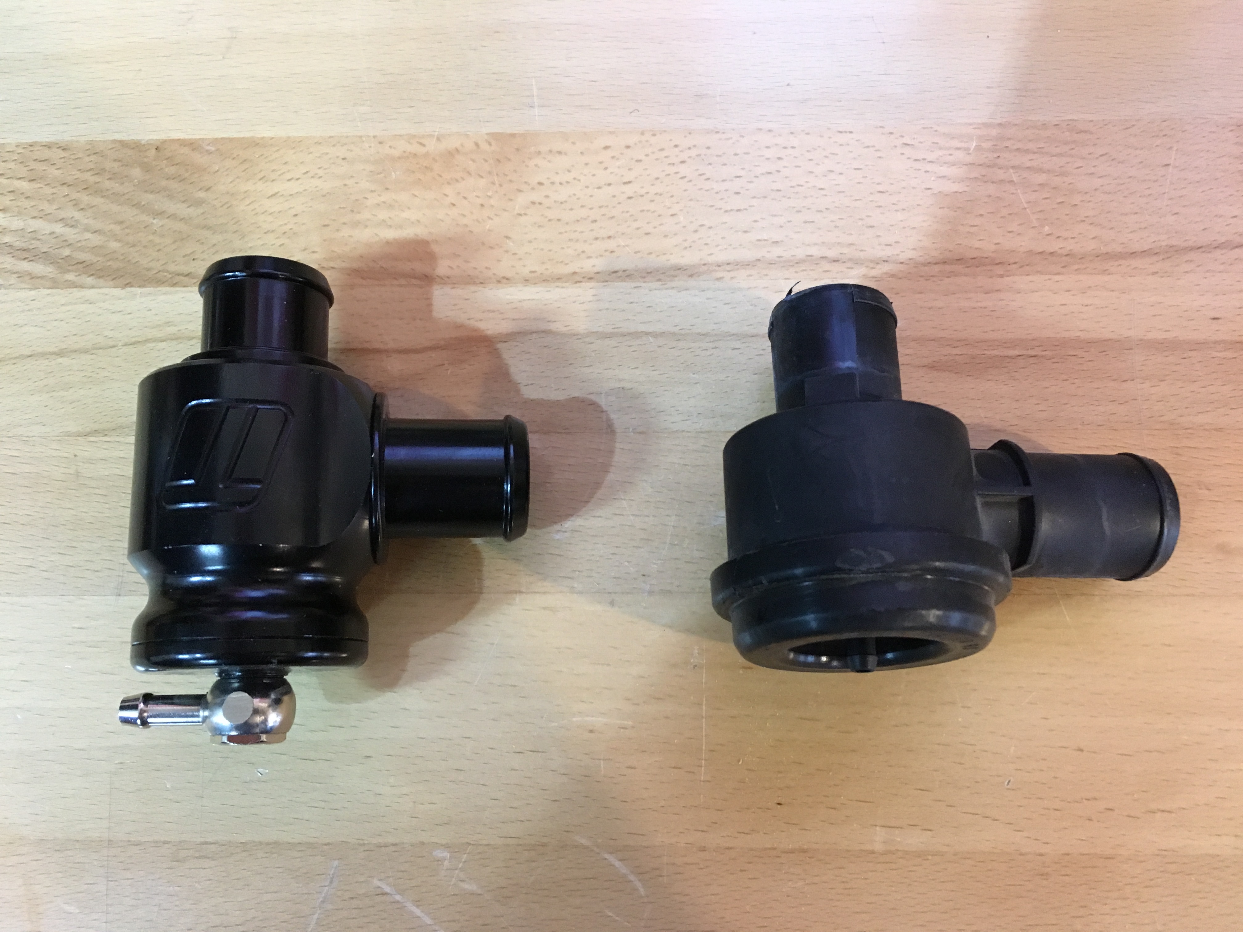

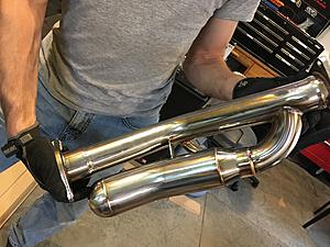

Just wanted to post an update and give you guys a heads up. The Stillen advice to leave stock cats on for max power is total BS. I sadly took this advice and after a short while the cats were completely burned out and I had sold my ART pipes. When we took the cats off all the material inside was loose and rattling around.
After the ART pipes were installed, not only did it sound better, but it has way better low end TQ. This made no difference to my AFRs and they are still in the green except when decelerating. So my plan is to not retune.
Also, if you are running the Stillen supplied Bosch BPV you should throw that in the bush as soon as possible. It is a cheap plastic POS and my was leaking and robbing me of boost. Many thanks to one of the members here who put me onto the TorboSmart BPV which is such a nice piece compared to the Bosch. With the Bosch I was only getting 6 PSI. Now I get the full 8 PSI. When I had complained to Stillen about low boost they told me it was because of my altitude (2300'). Thanks Stillen!

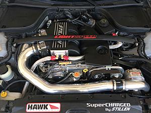

I have owned the car since 2008. Bought it with 3K miles on it so it was pretty much new. US car from Arizona. The first mods were the Stillen G3 intake, ART pipes and the Invidia exhaust. Got an Uprev tune and a pretty disappointing number of 280HP. Yep... I know that dynos vary a lot. It was still fun to drive and I had a blast. A few years later I was tempted by the new Q series, but instead opted to go FI on car. I thought it would be faster and cooler. I had no idea how much in the way of a headache it would be.
I opted for the Stillen kit vs a turbo. My mechanic was impressed with the kit, but there were a few deficiencies, Which I think a have addressed over the last 2 years.
Here are the highlights of Mods:
Power
Stillen V3 SC
FB Intercooler Upgrade
Removed air filter block plate and replaced with AEM socks
Uprev custom tune (a few times LOL)
Invidia exhaust
ART pipes
Southbend Stage 3 clutch
Aluminum driveshaft (one piece)
SPL differential bushings
Suspension
Hotchkiss sways
SPL end links
Strut Tower Brace
Other
Custom 3M wrap - Lemon Sting
Custom gauge pod - Innovate Boost and AFR
Custom mount Escort Max 360
Laser defense system (ALP)
Alpine type R sub in custom side pocket enclosure
Stealth mount 600W amp (near spare)
Digital Designs Audio processor
OEM 19 wheels refinished to gunmetal (285's in back, 255 front - Pilot SS)
Carbon lip and accents
Hawk Brake pads
Nav system hack to enable menu and search while in motion
At last dyno (prior to the aluminum driveshaft and BPV) I pulled 163HP over my NA number on the same dyno, same tuner. So, I'm happy now, but it has taken a while and a lot more $ than I thought it would.
