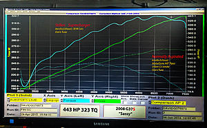

Stock TQ at 3K is nothing special so you can't expect huge snap. When I was NA with intake, ART pipes, and exhaust it was only 235 TQ. I wouldn't expect the "bog" or hesitation you are describing though. I don't get good throttle response till I am in the 4K range
