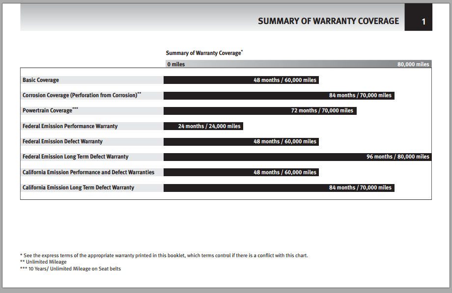

Remember that the powertrain warrantly is 72mo, 70k mi. If you're still covered, get it towed to a dealership.
not 60k?

Originally Posted by PNW_IPL
not 60k?
bumper to bumper is 4/60, powertrain is 6/70

From page 8 of the warranty booklet for your year car.
https://owners.infinitiusa.com/iowne...ation/warranty

I got this car used. Is the warranty period still the same?
Old Nov 28, 2017 | 09:27 AM
Likes: 4,951
Yes, as long as you don't have a salvage/flood damage title.
