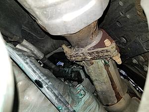

So it looks like another hose leaked on me. It's the heater hose going to passenger side firewall
The hose to the firewall is fine but the one from connector to engine is leaking from under the coupler(I believe that's what it's called)
Does anyone know how much dealership charge to replace it? I see the leak from under the car but it looks pretty tight to get to. Has anyone replaced this before & if so, please give me some pointers.

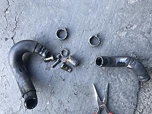

Well after I initially inspected, I thought it was the hoses the cause of the leak. So I had bought the 2 hoses at my DS and stopped at a auto parts to get some clamps, went with the ones that have the removable butterfly on them. I first started to with the two clamps on the middle where the pastic connector is at. Well right when I put pressure on the clamp and slightly shook it to "break it free" from the hose, the plastic connector gave up. So about an hour or so later I was at the DS again, now for the connector. When I tried removing each hose from the engine and the heater core, but found rather difficult. Since 1- I had new hoses 2-wasn't going to just replace the connector and 3-wasn't going to drive back and returned the hoses that cost me about 10 bucks or so.. I just decided to use my razor knife and facilitate the removal of the hoses. I inspected the all ready broken connector and as I tried taking it out from the hose it was just breaking apart piece by piece. The installation was WAY EASIER and FASTER than the removal. Maybe after each drive or so I would inspect to make sure clamps were tight and that no leak was present.
Will post pictures in a sec.....
Attached Thumbnails Heater hose replacement:  Cost? Coupler fix?-img_1270.jpg   Heater hose replacement:  Cost? Coupler fix?-img_1223.jpg   Heater hose replacement:  Cost? Coupler fix?-img_1220.jpg

Coolant did come out, I was prepare for it with something under the car to catch it in, plus grabbed some old rags to not have a lot of it go down fast. Overall tho not a lot of coolant came out and if anything it was mainly from the connection coming from the engine, but I was expecting it and tried to install the new hose and clamp fast!
Well only reason I went with aftermarket clamp was, because I read somewhere else how that style of clamp looses tension after years..and my car being about 9 years and at about 140K miles I went with the new clamps, BUT if I would've had the long reach pliers I would've just used the old ones, since they were on pretty good and with good tension still!!

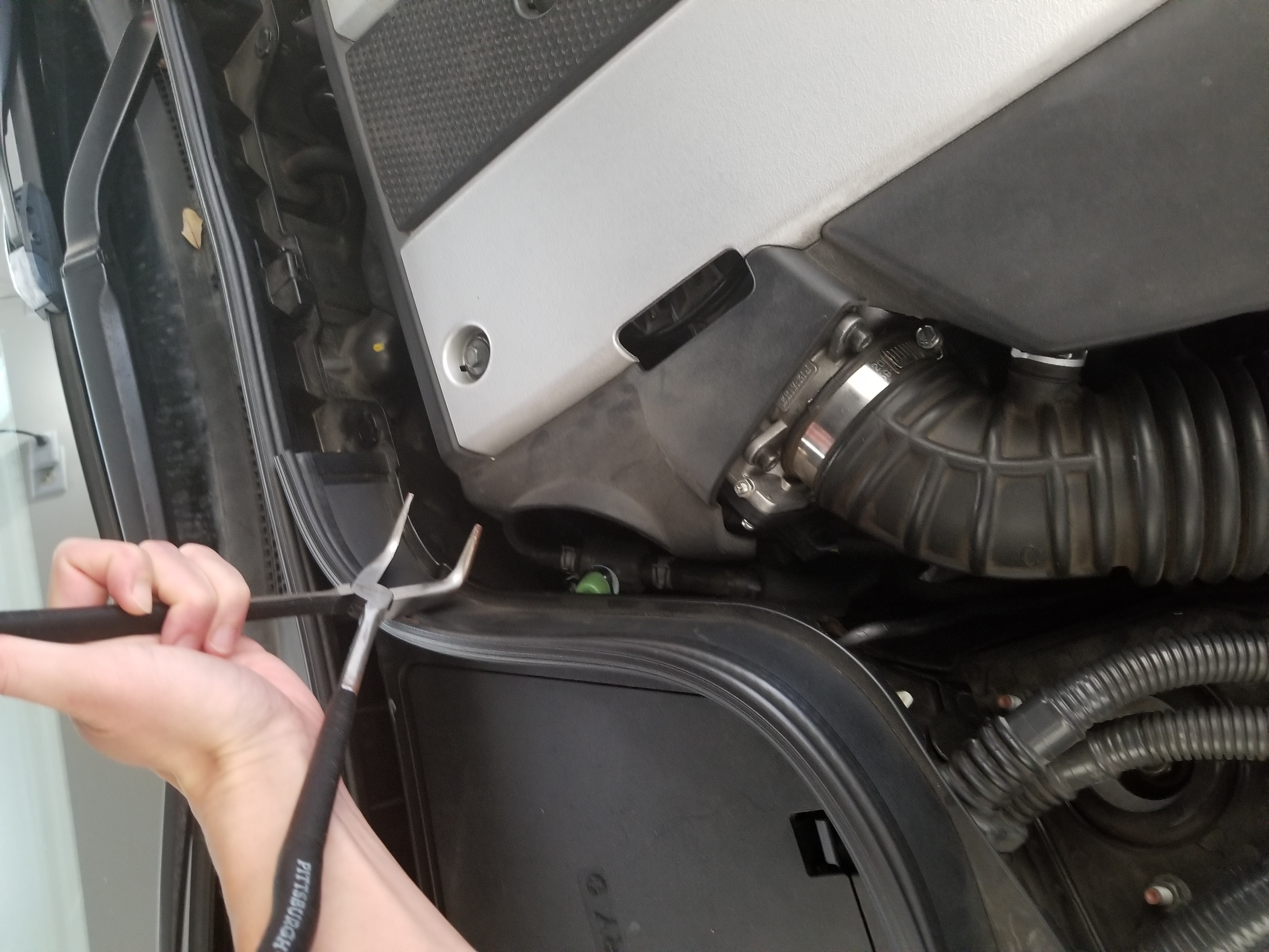

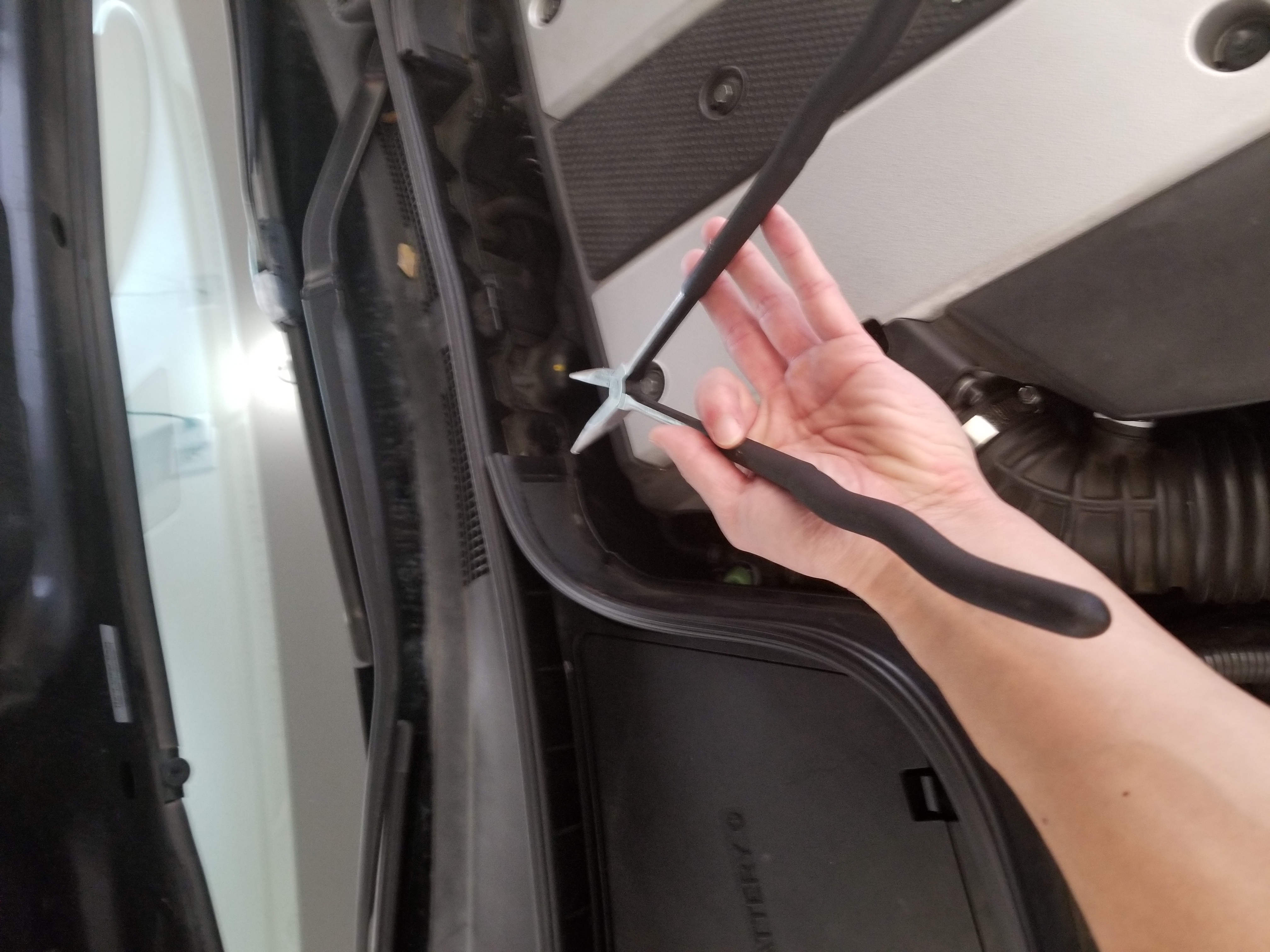

Replacement tips:
Before coolant draining, make sure you can remove clips from hose. The one to Engine is most difficult to get to. Remove engine cover & battery cover. Battery remove is not needed.
See tools from above post. The angle one go to hose clamp to engine. Position from passenger side gives best angle. The straight plier go to body hose clamp.
Once clamps can be remove, drain coolant. Do NOT remove hose until coolant is drained. See DIY for coolant drain. Connect all hose & connector to 1 piece be.fore installing. Put hose & clamp on engine first before one going to body.
Fill coolant & bleed. Hope no more leaks or missing coolant. GL
