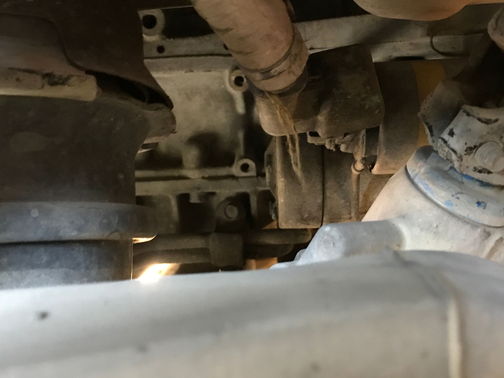

Hello,
I have a G37S coupe and my starter has went out. I have removed the starter from its slot and now it's stuck in its spot. I have already unscrewed all the bolts and inplugged all the wires. But my question now to you all is how I'm the world so I wiggle the little thing out of the small amount of space I am given. If someone has had to deal with this or something similar please help!!
-Thank you!!

try removing the lt side motor mount bolt on the bottom of the subframe and jacking up the engine.

Have you checked and followed the FSM?
Search is your friend!
Factory Service Manuals - NICO Club
See page STR 16
Removal and Installation
INFOID:0000000007470383
REMOVAL
1. Disconnect the battery cable from the negative terminal.
2. Remove engine undercover, using power tools.
3. Remove road wheel and tire (Front LH), using power tools.
4. Disconnect steering lower joint (1), then remove it. Refer to ST-25, "
WITHOUT 4WAS : Exploded View
(Without 4WAS) or ST-26, "
WITH 4WAS : Exploded View
(With 4WAS).
5. Remove engine mounting insulator (LH) mounting nut (Lower).
Refer to EM-69, "
2WD : Exploded View
6. Jack up the engine front side to create clearance for removing
starter motor.
7. Remove “B” terminal nut (A
