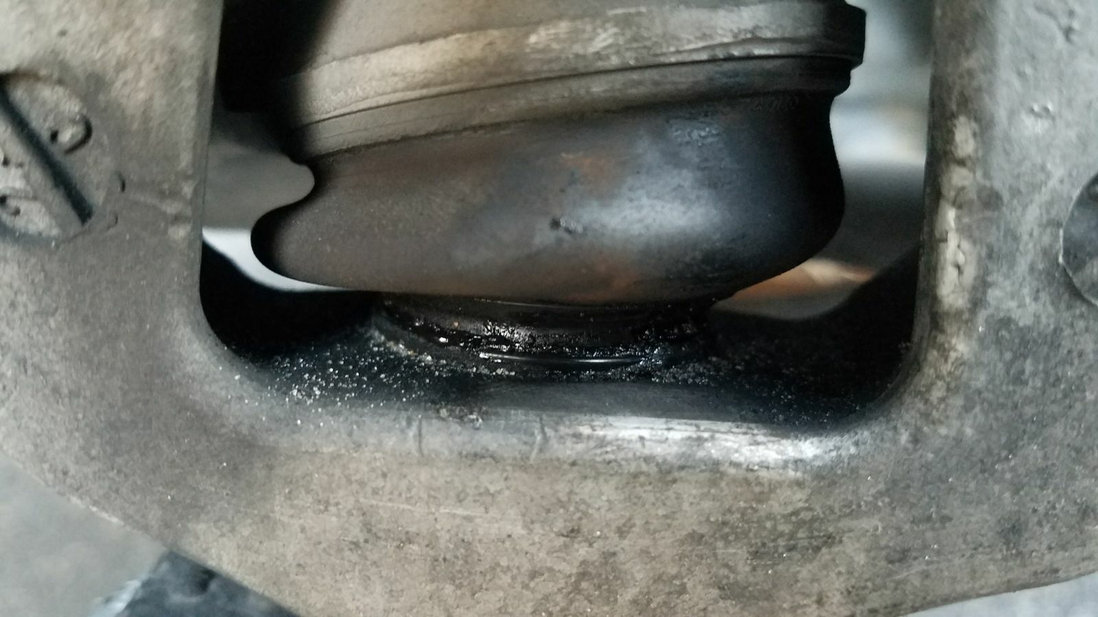

Could be this lower control arm outer ball joint? But man I don't see any play at all
Attached Thumbnails Could be the bearing?-img-20170704-wa0015.jpg   Could be the bearing?-img-20170704-wa0016.jpg   Could be the bearing?-img-20170704-wa0014.jpg

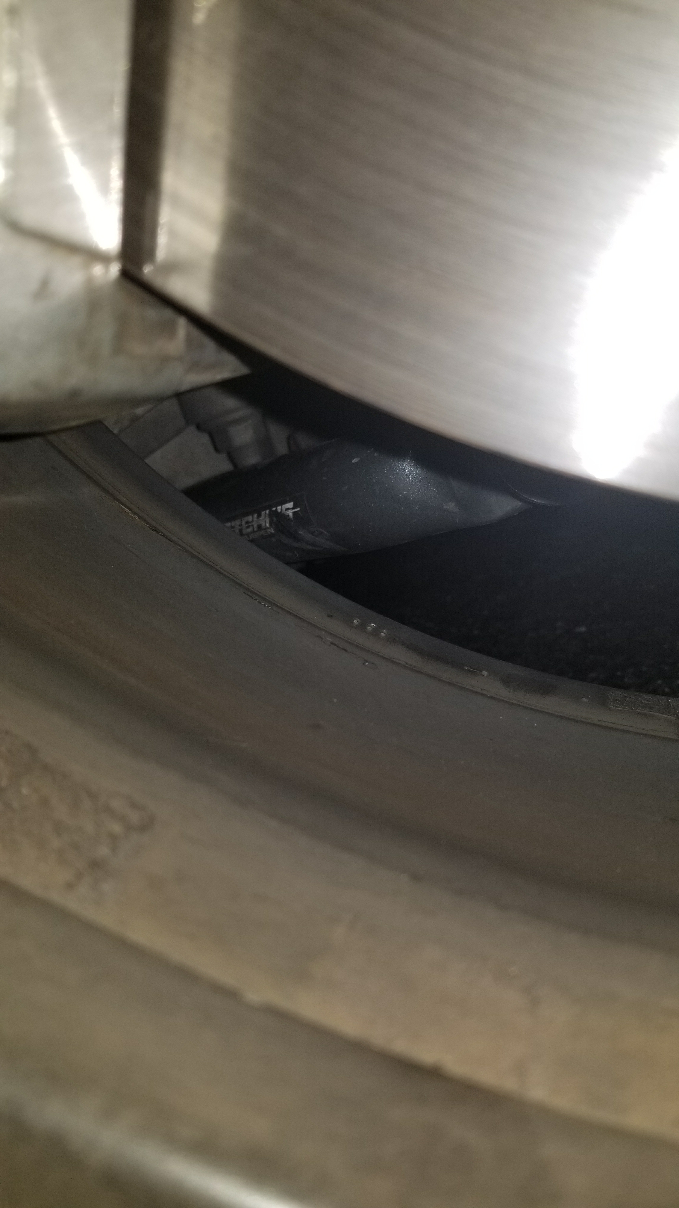

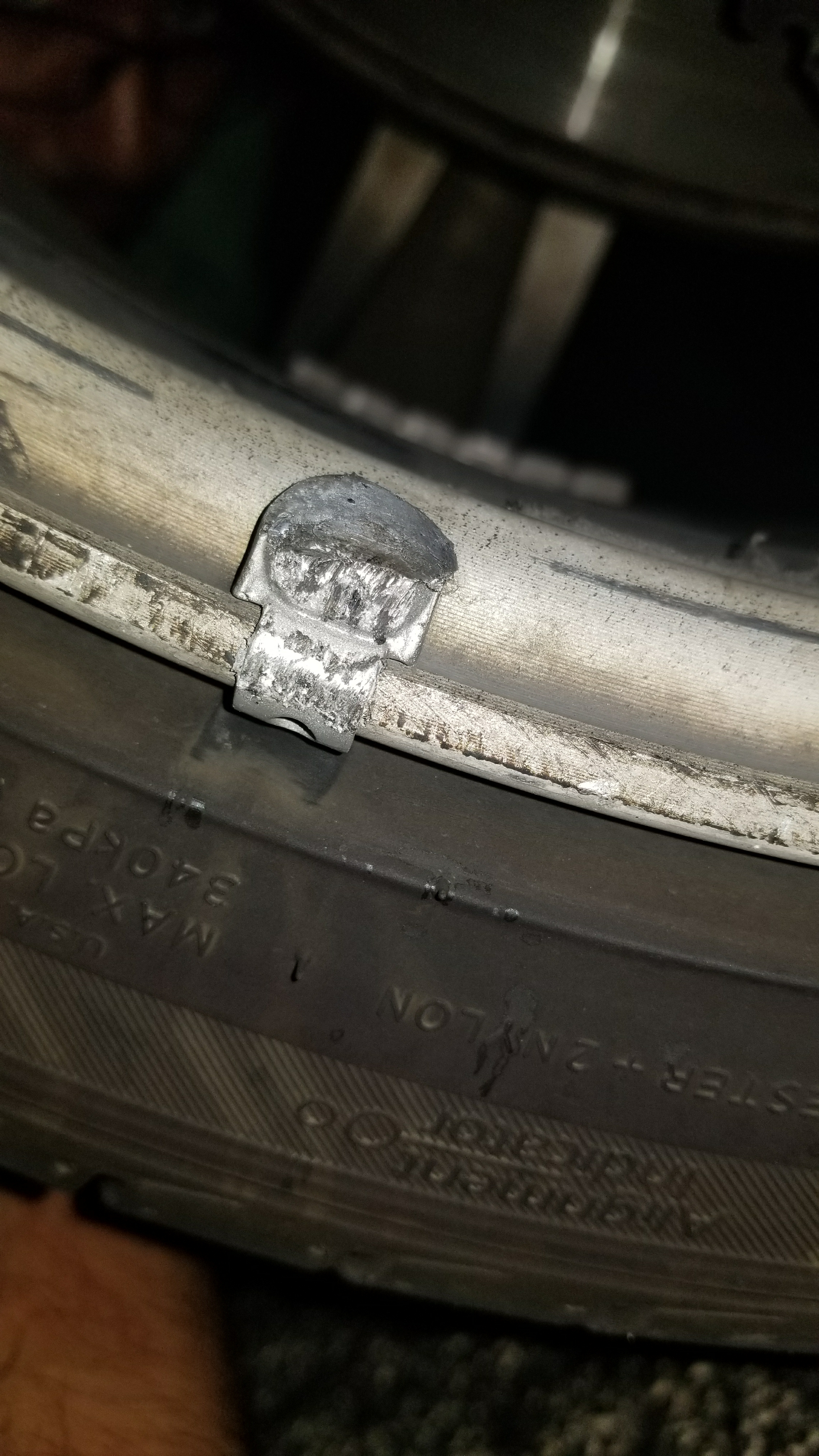

Dude.. You are a life saver.. Much thanks to you.. Apparently what happening was like you suggested one of the wheel weights were touching the sway bar.. Lol.. Never would have figured this out..
Attached Thumbnails Could be the bearing?-image-20170705_220347.jpg   Could be the bearing?-20170705_221409.jpg
