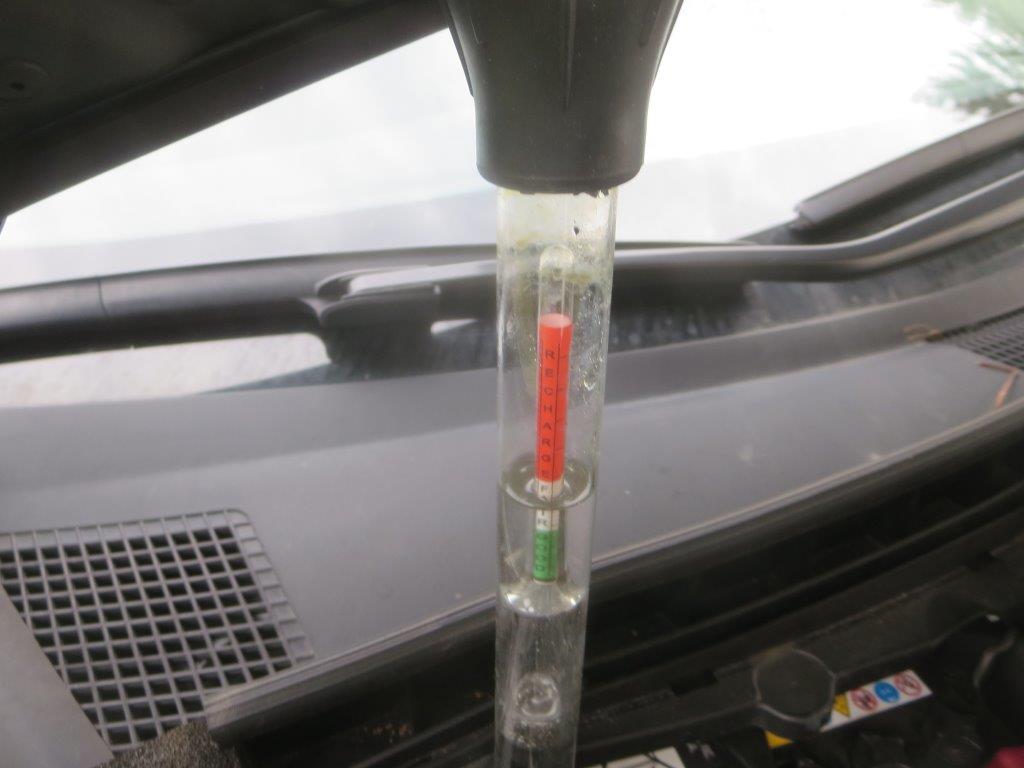

For about $10.00 go purchase a battery hydrometer and check the individual battery cells for a possible weak cell not holding a full charge.
Full charge
Half charge
