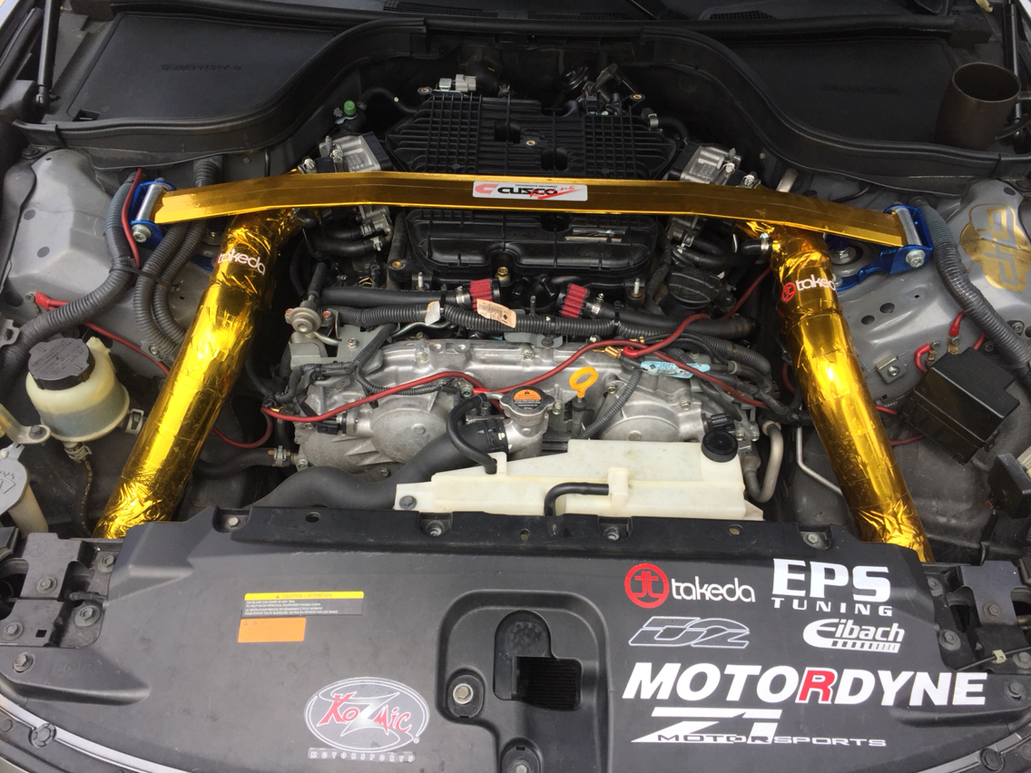

I wanted a dual catch can set and I've been researching for a bit. I know it's not necessary for these motors but after factoring in a tune and my plans for roadcourse tracking the car I thought that it wouldn't hurt. Regardless, the car will still have blow by so thought it'd be beneficial to me. While searching for vids on how and where to place the catch cans I came across a tutorial for EPS Tuning's PCV Delete Kit for a 370Z. Watched and thought I should check them out because it would eliminate the need for catch cans altogether and save me some money. I read somewhere on here that there was a concern about misting in the engine bay. I asked them about it and said there were no issues with that so I'll hold them to their word. I went ahead and bought a set of their G37 kit. Here's some pics. I haven't put serious miles on it yet so let's see how it goes. Anybody else every tried PCV Delete Kit?-photo408.jpgAnybody else every tried PCV Delete Kit?-photo655.jpgAnybody else every tried PCV Delete Kit?-photo956.jpgAnybody else every tried PCV Delete Kit?-photo74.jpg

I've done this on past cars both na and supercharged. After 3k miles it collected maybe 3 oz
So it's misted the engine bay?

No it stayed in the air/oil separator. I made my own using separator for air tools
