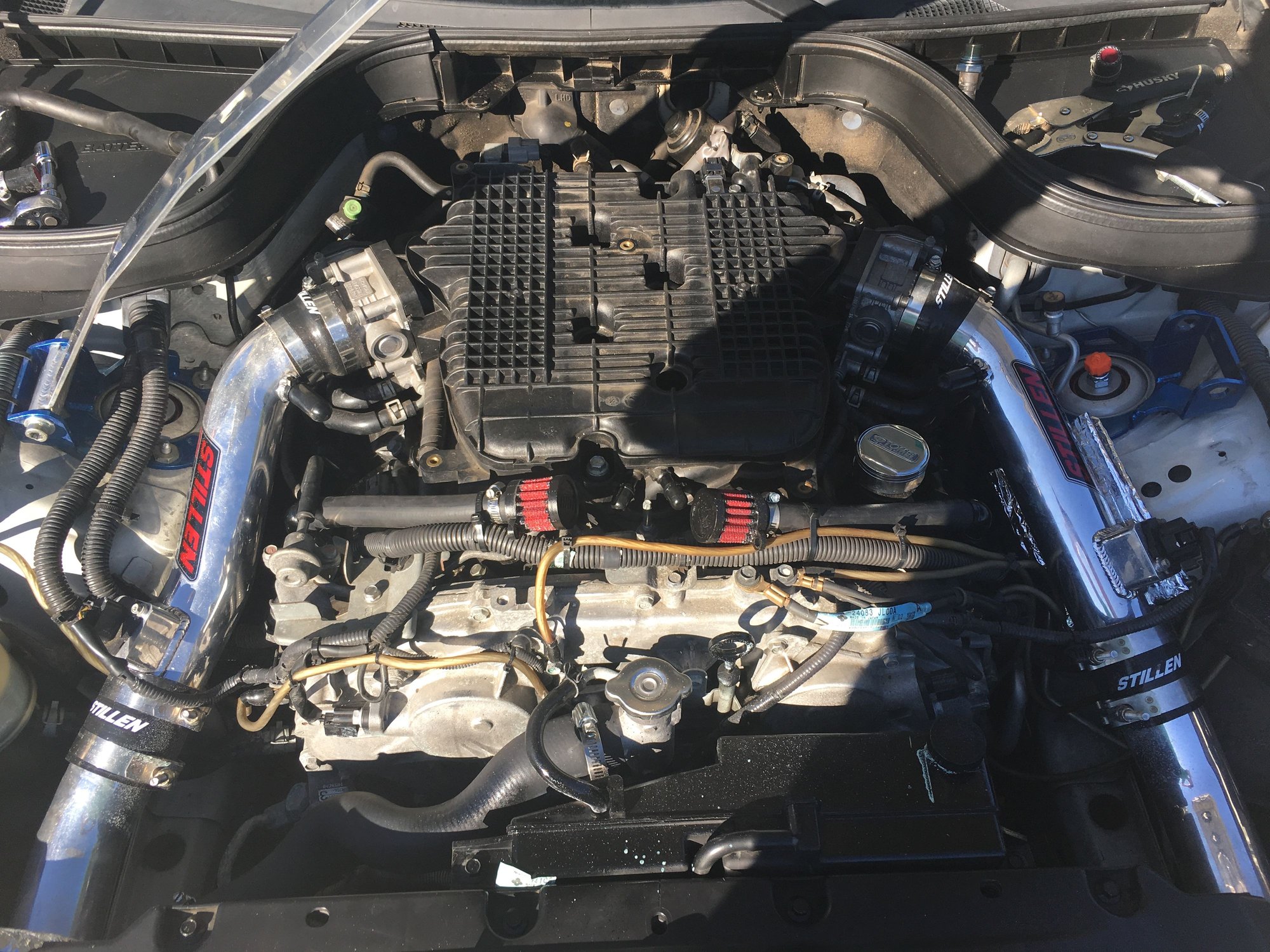

The PCV delete kit vents the crankcase, it does not cap it off. The manifold is capped off after the PCV valves are deleted since there is no crankcase recirculation back to the manifold.
The engine vacuum is so minimal even at peak (at idle) compared to the amount of pressure in the crankcase so the potential sealing effect that "4DoorFury" is bringing up is practically negligible in the real world.
I have used both the EPS PCV delete kit and open/vented catch cans that remove the PCV system properly with nothing but good results. If ring seal was actually reliant upon engine vacuum, you would see an increase in oil consumption, but I have never seen this in any case when using an open system.

running two breather filters is the same as remving the hoses off of the pcv itself. its not harming the engine. you're doing more good than bad by getting the eps pcv delete kit. if its so bad then tell Fast Intentions, boosted performance and AAM that two filters inplace of the pcv is wrong. How in one sentence its fine on a Boosted application but not fine on a NA application? blow by is blowby... and if your filters chugging smoke, then the piston rings are fired and the delete kit is STILL helping by not putting that EXCESS vapor into your intakes....

Nice overall quality(not much to the kit). Very easy install, even for me haha. Took 30 mins and followed Alex’s diy on YouTube for the install. I’m sure can be done in way less than half the time I took to do it. There was lots of oil residue in the hoses that I swapped and capped off. Extremely happy that is not going in the intake. Seeing that first hand, wish I had done this or catch can long time ago.

I don’t have any tech specs or fancy details like if it actually helps things or whatever BUT after having on my car for some time, me personally knowing what little I know now I would steer clear of just the pcv delete and go with a catch can. I have gotten some large amounts of oil residue that pretty much changed color from bright new red to super dirty blackish red. This alone is a deal breaker for me since these filters are hidden under engine cover and a pain to get to. Also don’t want hot oil all over anything under the hood. I would rather catch that oil in a can than use the system I have now..
