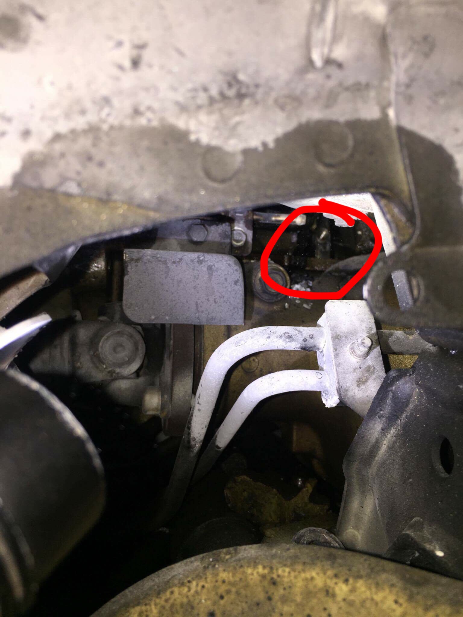

Background:
My G has been supercharged for about a year now. About 55k miles on the motor and trans when i boosted it. auto trans didn't make it through the dyno tune so I had level 10 fully build it for me last year.
What happened:
I was out a few nights ago driving it hard of course and noticed a sudden loss of power so I pulled over to find that the car was on fire. Managed to put out the fire before it did any real damage ( just burned some of the plastic liner). I towed it home and figured out that there's a big hole in the block when i inspected it. motor has 69k as of today.
What's Next:
So i got 2 options
1. I found a used motor for about $1400 with 62k miles on it. Get the used motor, install and retune.
2. fully build another motor and not have to worry about this happening again ( who do you guys recommend for doing the build and for parts)
Obviously the second option is the better option but it's not exactly cheap. The reason I put the first option in there is because I know this motor can easily handle 450-500whp with a proper tune. I've always had issues with my tune and I think that's the reason it gave out because the car was only making 356whp. Also, MAF location of the stillen kit could have contributed because it's reading the wrong IATs. stock pulley on the supercharger. Only thing i upgraded was the heat exchanger. I upgraded from the stillen one to the frozenboost one about a month ago.
Would be nice to hear everyone's opinions and recommendations.
