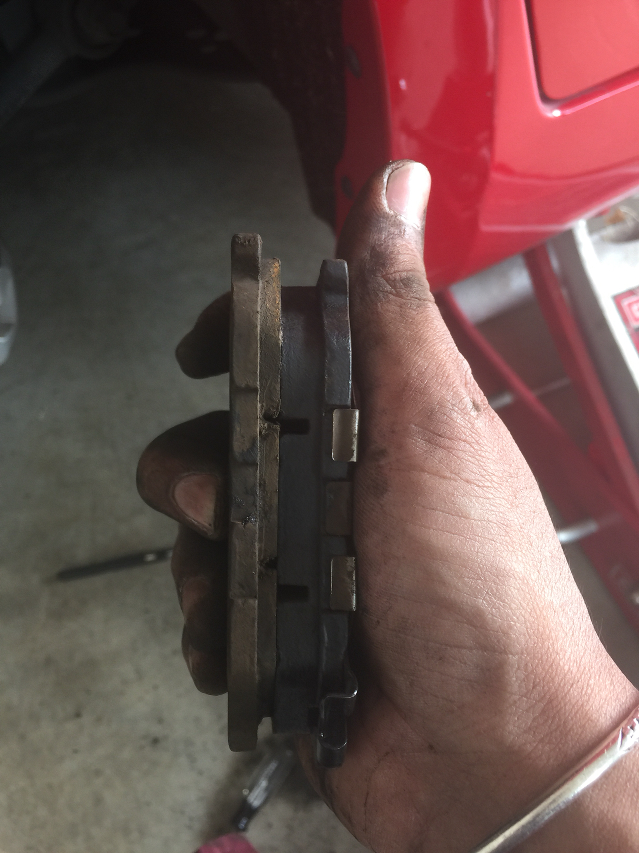

Old Apr 16, 2017 | 03:58 PM
ToXIc's Avatar
ToXIc
Joined: Aug 2014
Posts: 756
Likes: 105
Ok swapped out the rears, it still had some meet but willing to try a new set to get my car back. Didn't have time to look at the fronts let's see what happens in the coming week.
