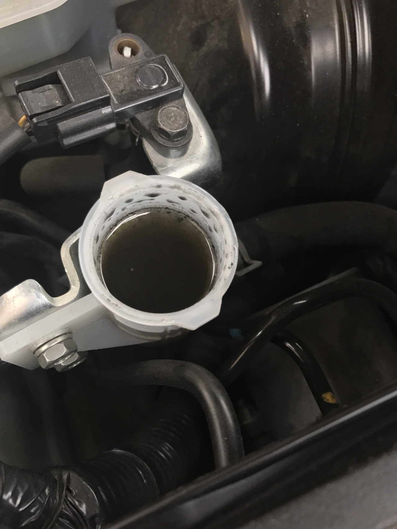

Oh jeez after reading all these posts I think I might be screwed again. I purchased the Z speed HD CSC and had my clutch fluid replaced with GTR blue brake fluid. Well within a few months it turned brown again and I have black floaties just like I had when my CSC failed.

^ did you replace the MC along with the CSC and fluid flush? if not, the service manual recommends this in bold. otherwise contaminants from one part can make their way into the new part and lead to failure.

yep, if you are putting an aftermarket kit on with an OEM CSC, youll be pulling it back out in a couple months

Got the car back from the dealer today. Here is what my current clutch fluid looks like. This is after about a year with the new CSC. You can see black bits floating around in there.
Wow, definitely flush that fluid out before it contaminates the rest of the system.
Not a bad idea, but it's probably too late. It's been like this for almost year. But probably still a good idea to prevent further damage, and too see if more particles emerge.
