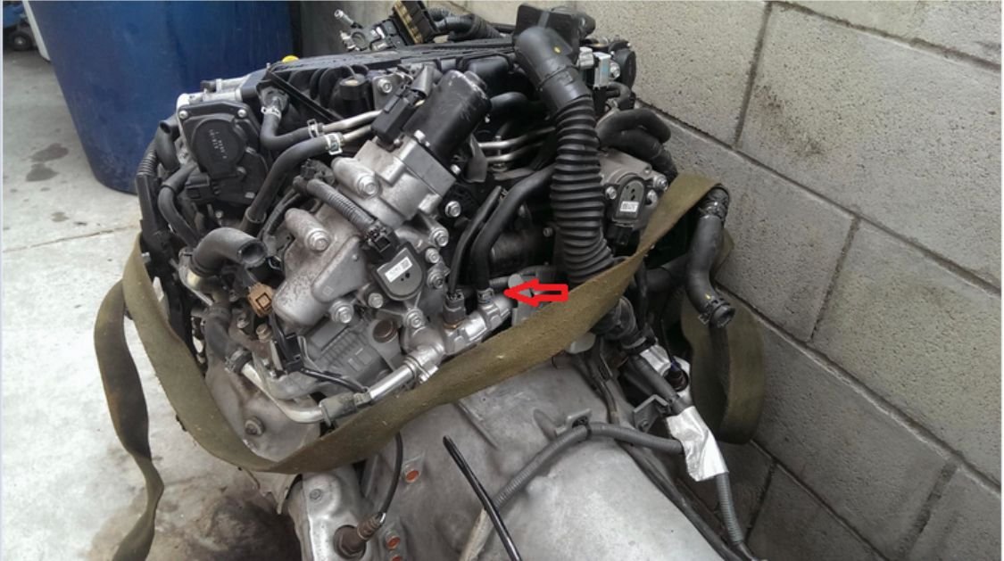

This is the hose clamp I’m speaking of. Using a mirror and flashlight I can see that this is the source of my leak.
Old Jul 24, 2019 | 01:56 PM
  #51
Baadnewsburr's Avatar
Baadnewsburr
Posts: 1,784
Likes: 320
From: Toronto
those flexible hose clamp pliers I posted above should do the job (the hose I thought you were referring to is just to the right of it in the picture), I also use these https://www.harborfreight.com/11-in-...ers-64088.html and a straight version of them too...you probably want to remove your windshield wipers and the cowl along with the plastic around the brake booster/battery to get to that spot though if you haven't already...
That thread has the tool to use. A heads-up... gonna b more leaks on other hoses. I would change all so coolant fill is 1 time as oppose to each per hose. Chk my other thread for other hoses.
