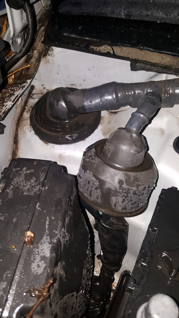

It took a while but I found the leak. There is a boot where the wiring come down out of the engine compartment. It appears that since it was parked on a incline and there was leaves built up in the fender area water was able to pour in past the boot and on to the ecu. I am cleaning it up and I will silicone the crap out of it so it wont happen again.
Just in case someone else has this same problem here is a picture of the culprit.Name:  20161207_171450_zpsrobu8p9y.jpg
