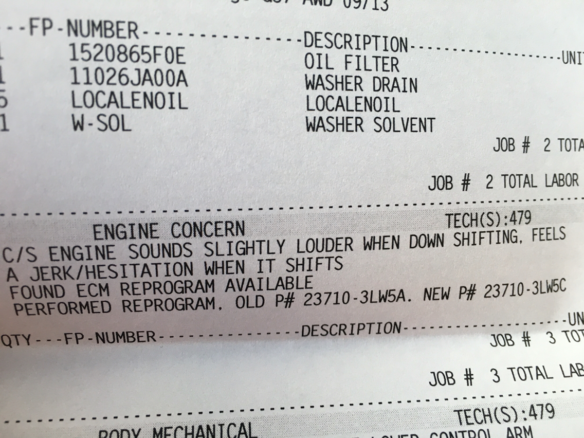

Originally Posted by mmorcos
I experienced something similar... Curious if yours is the same as mine ... Dealer programming code attached
Attachment 123037
Did they charge you to do the reprogramming? And was your car still under warranty at the time?

Posts: 15
From: New Jersey
NO charge since it's under warranty still , 2013 g37x, but it's an issue TSB... Dealers can't charge for recalls I don't think...?
http://www.infinitig37.com/TSB/ITB09-032b.pdf

TSBs are not recalls.

When I got mine flashed it appears I got ITB12-027d. Does that make sense? This was May '15. Has there been a newer flash released since?

Thats what I got done last October to get flashed, car has been progressively more numb, although the 2-3 and 3-4 upshifts are better. I paid $125 since TSBs are not recalls.
