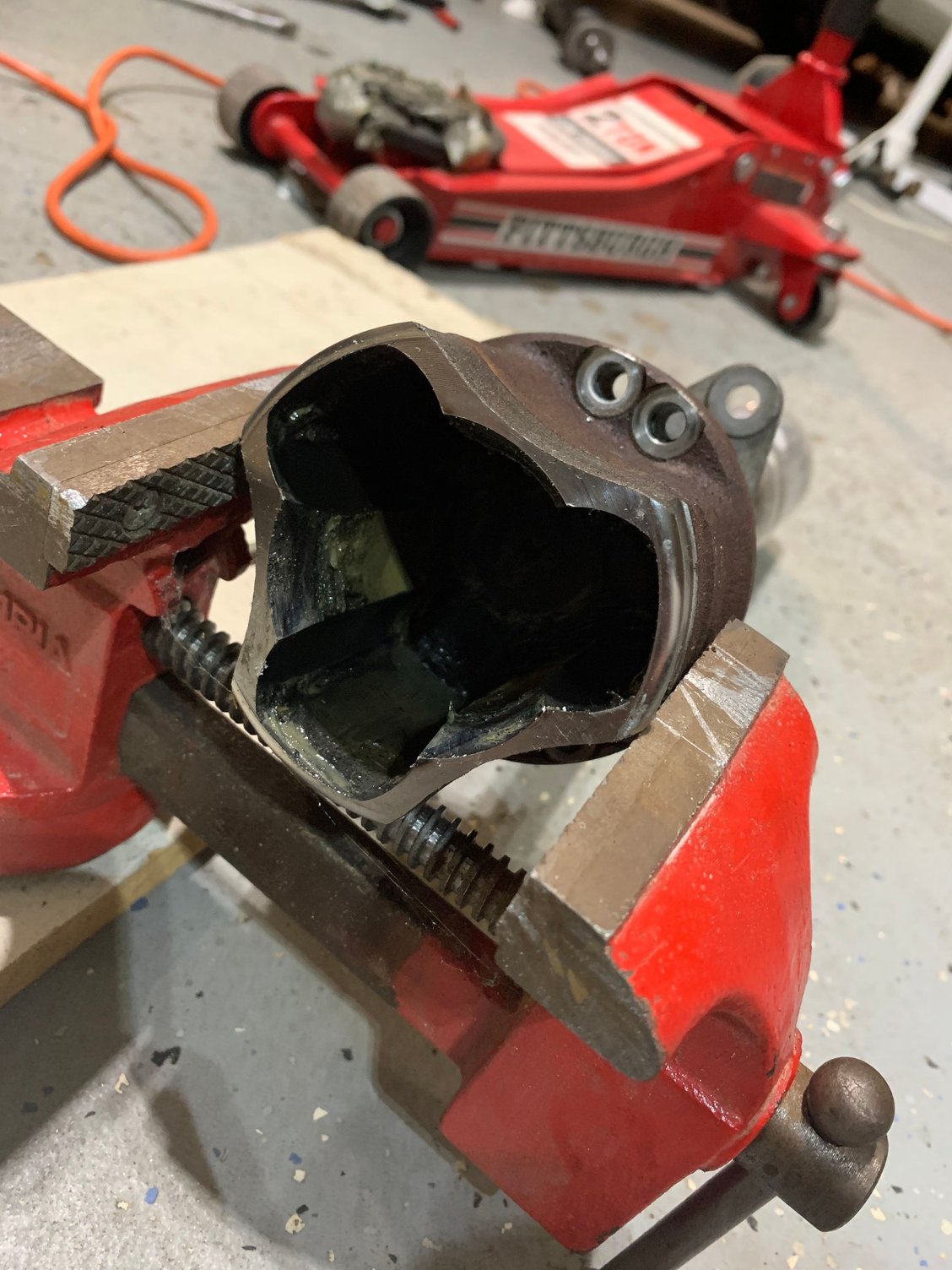

old post, but I may give some extra information for future reference to hopefully help someone out in the future. I just took apart my right side front axle, etc (as the inner boot was torn).
a). no need to remove the whole axle from the transmission etc. you can just cut away the original rubber boot if that's the reason you are removing to fix it (like in my case), and just remove the axle without the housing etc that goes into transmission.
b) the original cv boots are made by GKN - and the inner passenger side boot is exactly same as they put on 2007-2015 Mini Coopers. it may be cheaper than getting them from Infiniti. Other models of cars may use the them too, didn't check yet.
https://www.gknautomotive.com/en/Aftermarket/
https://web.tecalliance.net/gkn/en/home?sessionArticleCountry=GB&sessionTargetCountry =GB
- catalogue
Also please note that the left inner boot is bigger than the right inner boot. The outer boots should be the same.

******* notice ******
if you are removing your axles to fix a torn boots, you don't kneed to remove everything from the transmission!!!!!!! If it's the inner boot that needs replacing, just cut away the boot and you can remove the axle without the piece that goes into the transmission and/or removing those bolts you can't get to.
If you need need to fix the outer boot, you could in theory take off the metal band off from the inner boot and slide the whole thing out. (def easier than having to remove the bolts and the left side, or prying it out of the transmission on the right side)
of course this doesn't help if you need to replace the whole axle.
Let me know if you have any questions.
