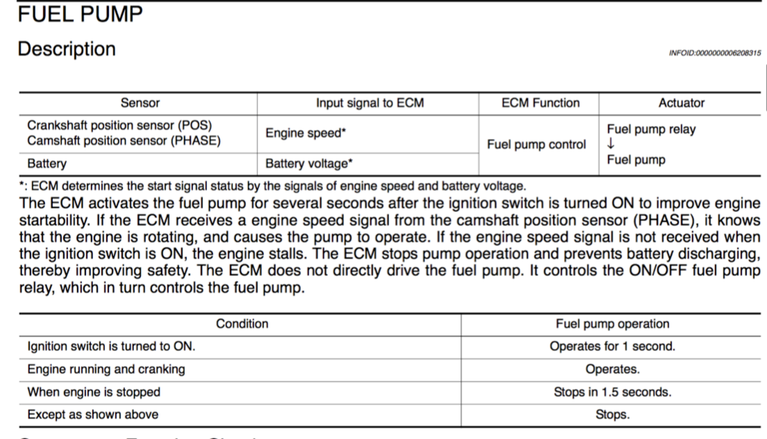

I think your Nissan engineer described the throttle body operation. The fuel pump is either on or off. There is no pulsing of current.
Here is a snippet from EC-519 in the factory shop manual:Infiniti G35 / G37 Factory Service Manuals - NICOclub
Here is a quick test for fuel pressure:
