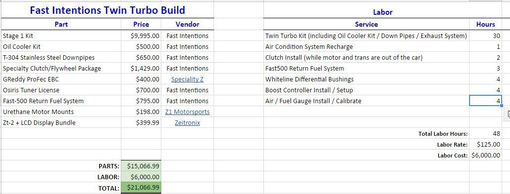

Originally Posted by jpowersjr2
I'll be nice and share the spreadsheet I created. A majority of the info I got from Kevin @ Fast Intentions. If anything is missing/not right, that can be blamed on me. I think that's about everything unless you're going to do a full engine build as well. The labor rate is just an approximation.
Speaking from experience, this is very accurate, assuming you don't need an exhaust. There are other little things you could do, but this hits the main points. Make sure you have a backup means of transportation as there are always kinks in the beginning that need worked out. GET A GOOD TUNE. Do it right once.
+1 on this. You're looking at $20-25K ish for a build with clutch, exhaust, labor and other random stuff depending on what you have already. Drift Office had me at 60 hours of labor, I think it might have actually been more but they threw a bone or two.
Also though, as a prerequisite make sure your suspension, wheels/tires, and driveline can put that power down and keep you on the road.
