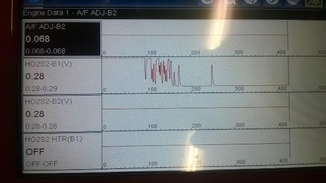

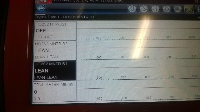

Or vise versa? I had two realy bad rear 02's. One was actaully telling the ECU is was lean and the car was super rich, car stunk, LOL I forgot to update here also of the readings. One reading was .29! Tech told me it is impossible to go over .28 :O, and that 02 was a flat lined DEAD LOL
Attached Thumbnails P0420/p0430?-rear-o2-reading.jpg   P0420/p0430?-rear-o2-reading2.jpg

Huh. Interesting that the car was changing timing off the REAR O2 sensor - I've never seen that before. So yup, there's your problem right there! Glad you got it sorted!

So car is still pig rich at idle, brand new 02 senor is still show "LEAN" and CEL light is back on after 40 miles same 4 codes!! P0420 and P0430. To be honest with everyone here if I can not get this ironed out this weekend when the car goes in to have the drivers side header replaced I'm putting all the stock stuff back on and moving on. I will have Z1's HFC's. Stillen Headers 1 brand new other 2 weeks old and Takeda cold air intakes for sale, only thing I don't have is the stock cat back so I cant sell the ARK . I am very frustrated right now I don't have time for this. Yea maybe I shouldn't mod :/.

If the new sensors are still reading lean, then it's upstream or not related to the O2 sensors being faulty. If it's still pulling timing, it's related to either a sensor (my guess is knock sensor), or an injector not spraying in one cylinder, and detonating in that cylinder. I'd look at the sensor before I looked at the injector. But then again, if it's rich at idle, and lean while cruising, then it could be an injector that's clogged, limiting it's flow. Either way, it's pulling timing because it's getting a lean reading. So the two questions there are 1) is it 'actually' running lean, or 2) does it falsely 'think' it's running lean? If it's actually running lean, I'd point to an injector. If it just thinks it's running lean, then I'd look at the knock sensors.
