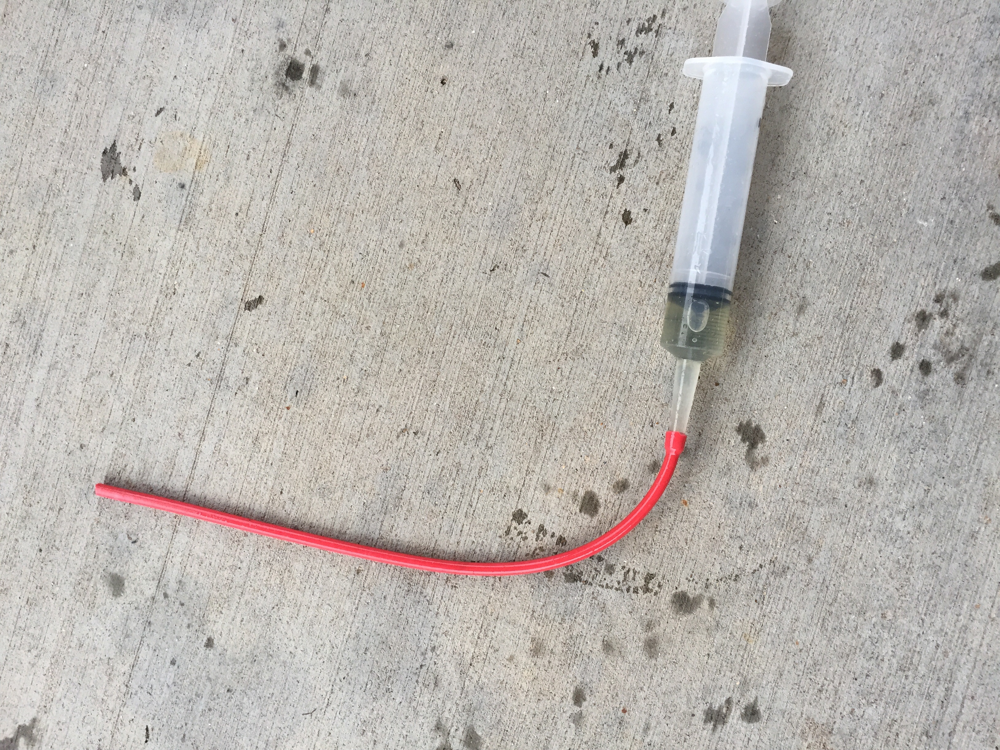

I went out to my 09 sedan to find the clutch pedal completely soft with no pressure at all.. I had a look at the Resivoir and it was empty! Now I've looked everywhere and can't find a leak so I've filled the resivoir back up and nothing has changed... So now I've come to suspect air in the line. I was trying to reverse bleed the system by attaching a make shift pump out of some medical supplies I have laying around and attached it to the bleeder screw pressed the clutch in and tried to push the fluid back through to force the air out... Didn't work .. For some reason I can't force the fluid back through the system... Am I missing something?
I'll post a picture of the set up I was referring to.

I don't think that thing you've put together there will do it. Maybe gravity bleed it followed by the old fashioned way of using the pedal to pump the air out. Slowly and methodically. This clutch system I can be a bit tough to get all the air out.

So for an update I could never get the thing to reverse bleed. I saw a post in the 350z forums about a guy using a pump oil can and attaching it to the bleed valve and then engaging the clutch then forcing fluid (and the air) up through the system. However I couldn't get it to flow. I tried to do the two man thing and pumping slowly.. There is brand new brake fluid coming out of the bleeder valve, but when it's closed and the pedal is released there is no pressure. It feels like I'm chasing my tail. When I pump the clutch I hear fluid moving through the line pushing air around. The best way I could describe it is if you held a gel bag in your hand and squished it. I guess I'm gonna be replacing the csc, but it just seems a bit young of a car to have this happen already.
