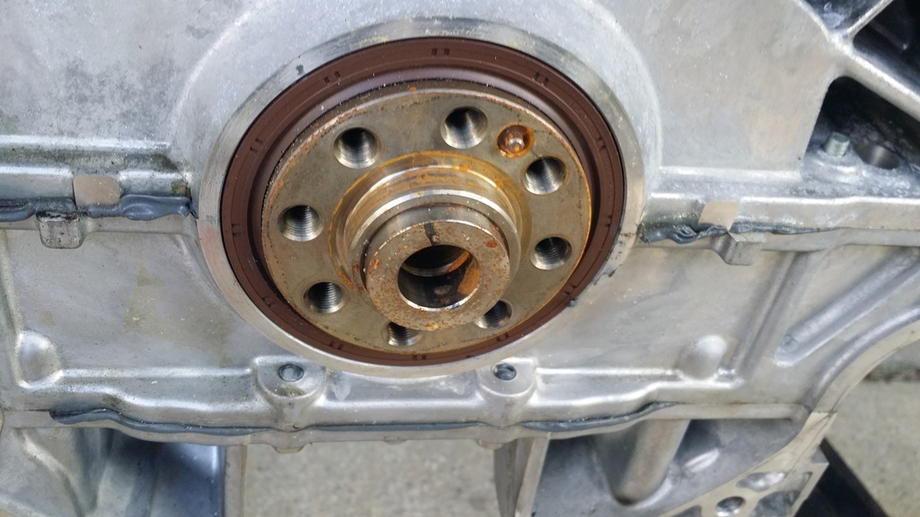

I'm swapping in an automatic 350z motor into my G. I got everything off except a few parts.
On the rear of the crank there's an extra sleeve pressed on the inside of the crank. How can I go about removing that?

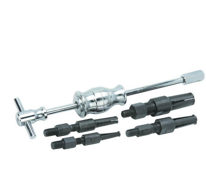

Found the answer for anyone who needs to know. It's called a pilot converter. I bought a bearing puller kit from harbor freight and was able to get it out easily.
Blind Hole Bearing Puller - Needle Bearing Puller
