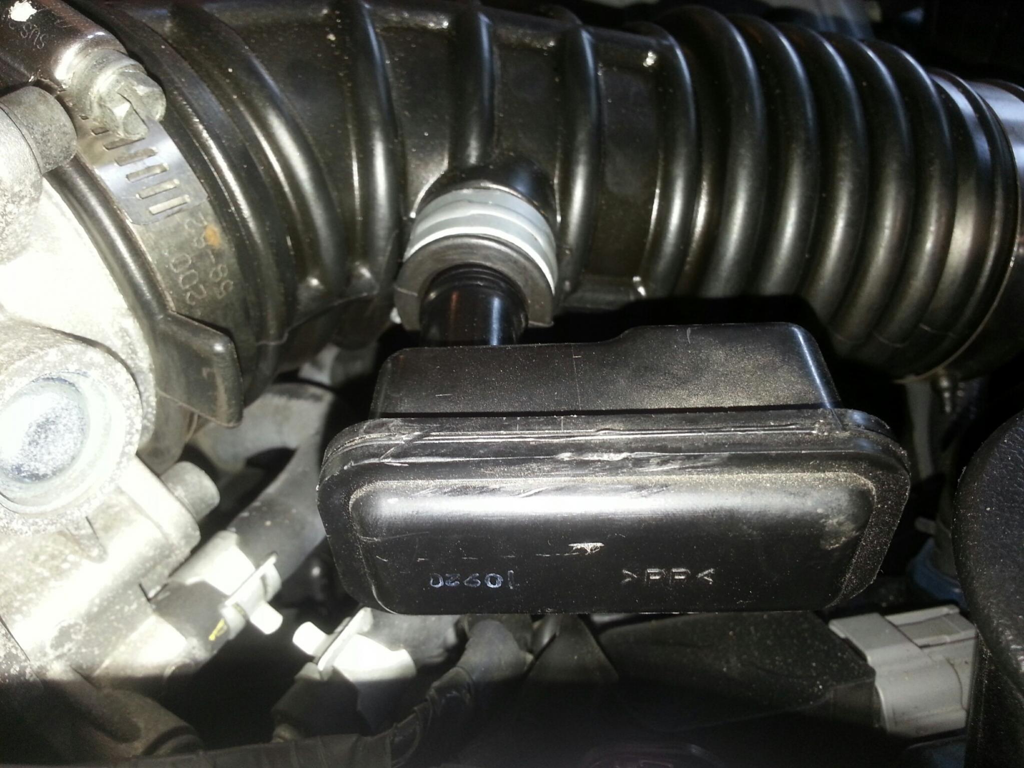

I finally got around to installing my intakes and I found this part broken.
My question is should I put the OEM parts back or continue with the intake install? Either way it is broken already.
Anyone know what part or number that is so I can look to order a new part for it?
The car is still under warranty so I'm thinking I should just put all the stuff back and take it to the dealership but I'm hoping that they don't think that I broke it. I'm sure they will....

Which intake are you installing? Most aftermarket intakes get rid of that part altogether.

My R2C's did not have me reuse that part. If it's still under warranty, tape it up for the drive to the dealer and see if they'll replace it under warranty. If they say no... Then you're better off installing the K&N (assuming they don't require the part). You can always research the part later and buy it much cheaper online than what the dealers gonna charge anyway.

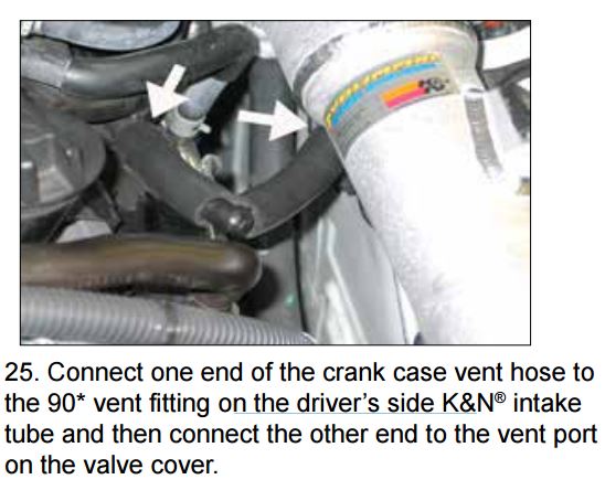

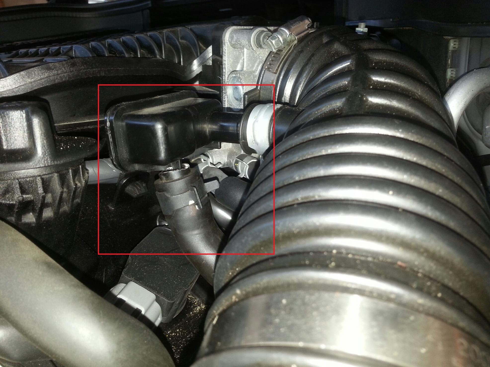

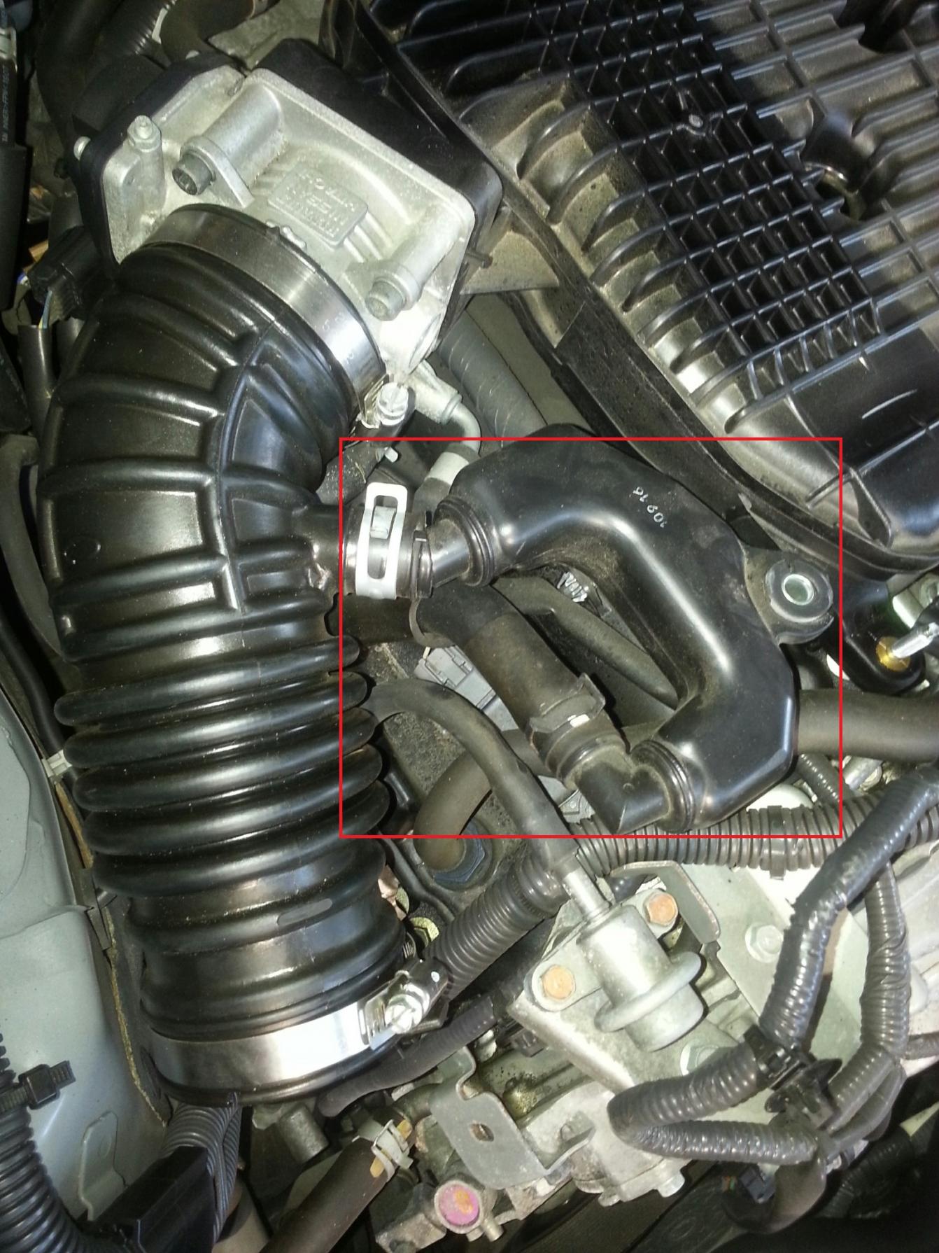

So looking over the instructions again, it does truly look like I'd be removing both stock vent boxes <in red on my photos> from the driver and passenger side of the stock setup. Can anyone confirm this or have better photos?
It seems like with the K&N that I'll just go from there pipe's 90deg with their tubes straight to the car and remove these two vent boxes and extra pipe on each side. In that case, no point to get it fixed other then having the stock part when/if I needed to put back the stock intakes.

Just delete it. If your kit doesn't have replacements then get z1 side intake tubes.

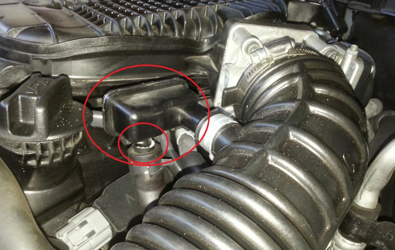

So I've found out from the dealership that they won't fix it under warranty. Plus they want to charge me $245 bucks.
Looks to me that the driver side is Part Number: 16576EY00B Left. But this only confirms for me from the local dealership that this little box isn't sold separately so I'd be forced to purchase the entire intake hose and connections, including the little box I wanted to get fixed.
2012 Intake Parts
My kit for the K&N Typhoon did come with 3 hoses that do connect straight to the PCV value on the engine. 2 go together to form the 90deg connection for step 25 (per above photo) and then 1 long hose connects on the passenger side, step 38 (per above photo).
So looks like I'm just going to switch to the K&N and delete the oem intakes w/ the extra hoses and vent boxes.

A quick internet search shows you can buy that assembly from several Infiniti parts suppliers for $100 or so. If you really want it, do not have the dealer do it. I would just throw the K&N in and keep the taped up part in case something goes wrong with the K&N.
