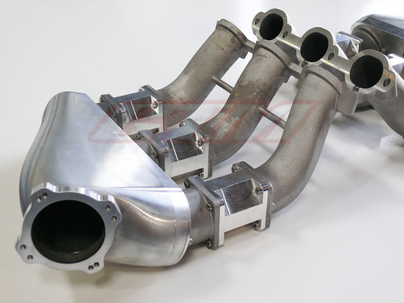

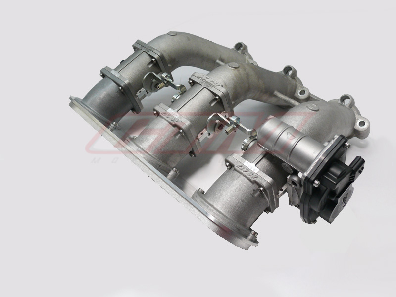

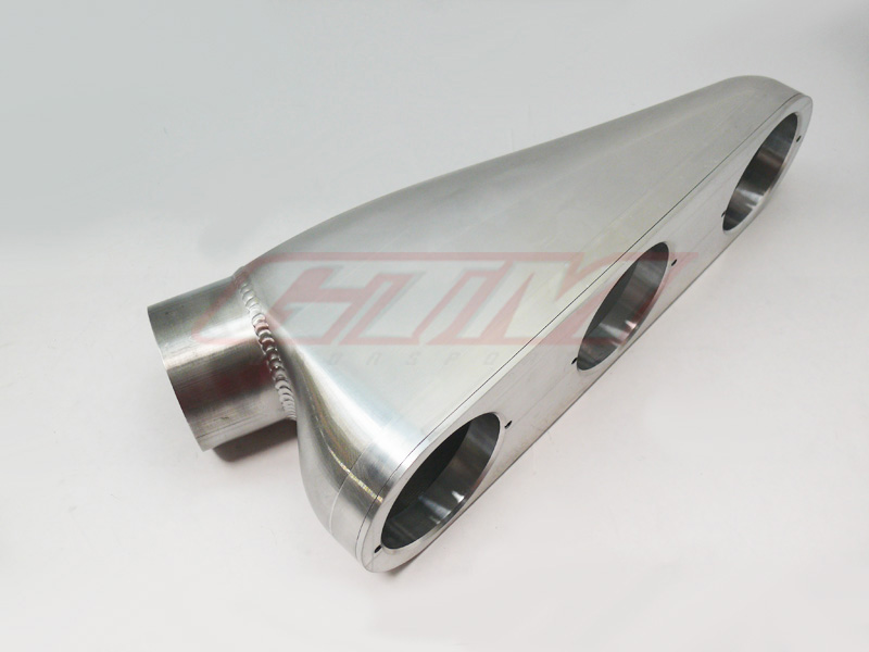

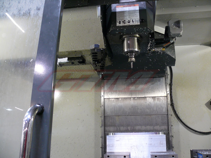

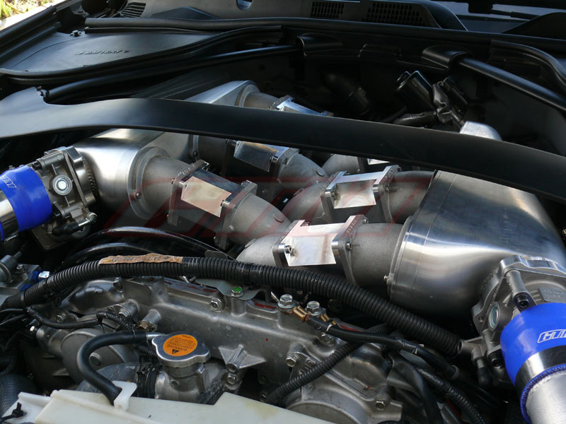

Okay due to much requesting here is a run down of the build and parts used. The car is an 09 sport 6mt and since I live near GTM I dropped by and went over what I wanted with Sam and went ahead and dropped my car off. The project was set to take a Mid level approach to an NA build as I wanted to see what could be done on the stock block and heads, and I also wanted to prioritize mid range power to suit my driving style and only moderately increase Upper rpm power. The plan was layed out to include a new manifold and fuel rails, new throttles, new intakes, new headers, open exhaust but still quiet enough to drive it around, a bulletproof clutch setup, dry sump oiling, increased cooling, and to run dual fuels and see if there was any gain to be had on E85. *as I get more pictures sent to me I will add them in here*

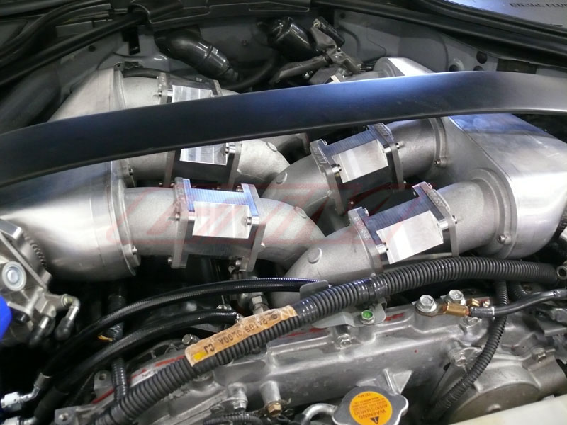

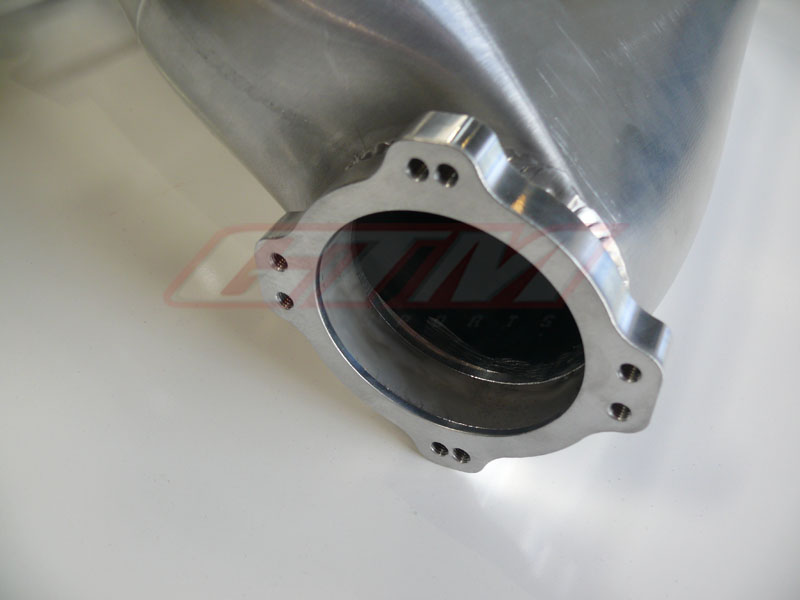

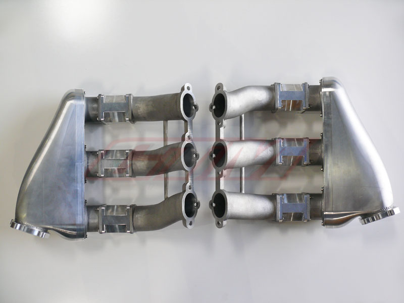

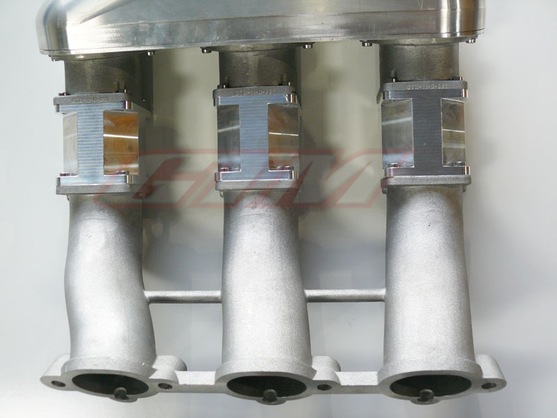

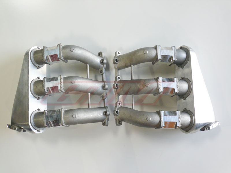

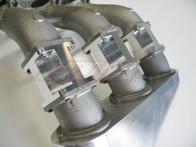

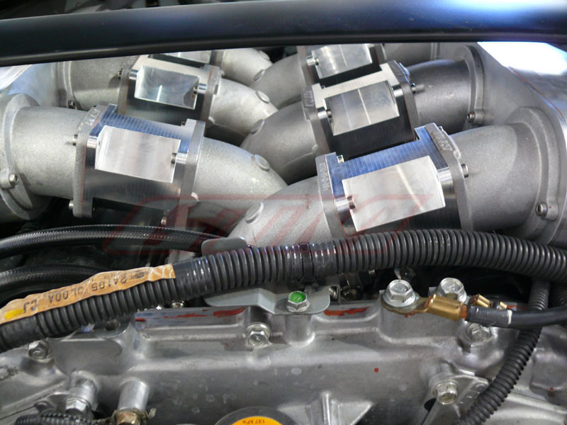

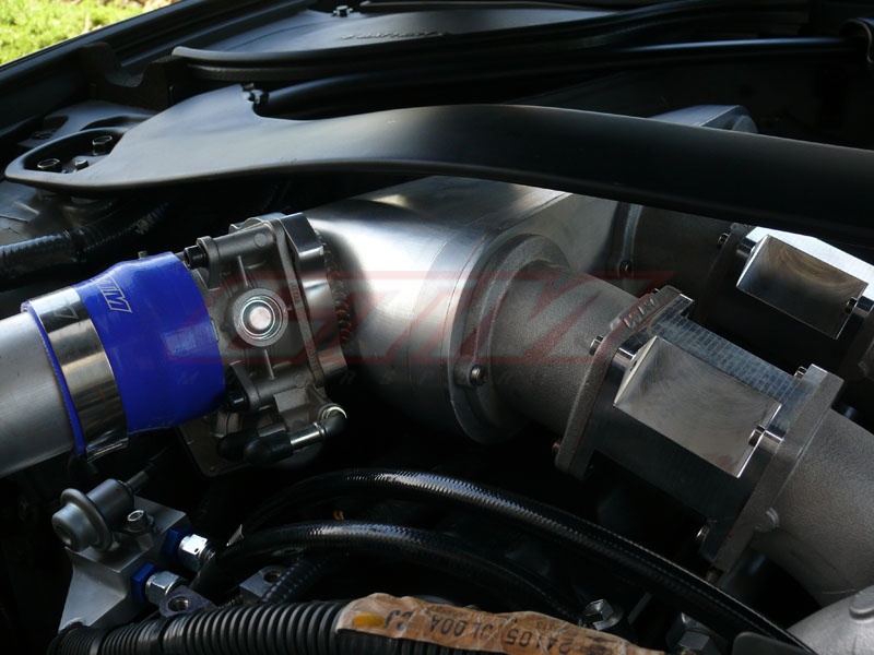

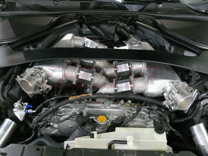

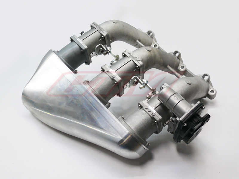

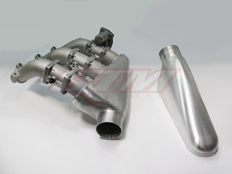

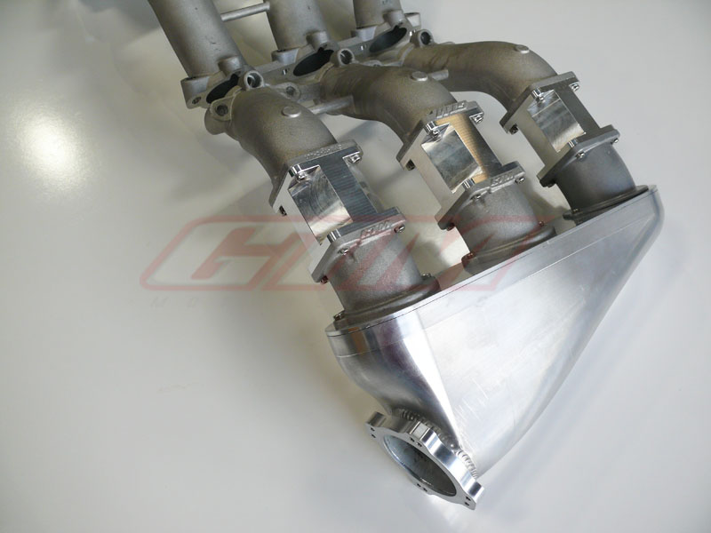

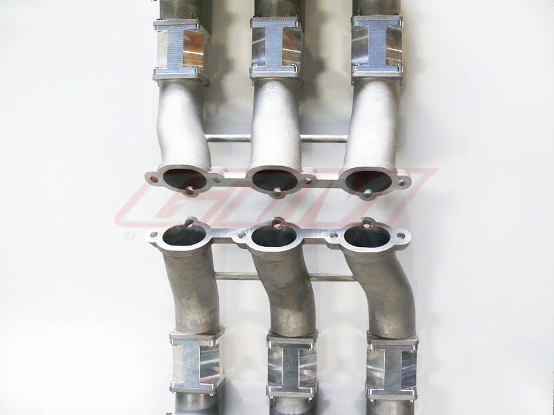

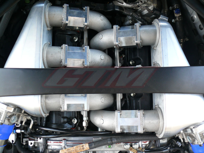

For the manifold it was decided to go with the GTM ITB setup, but it was custom converted to twin 3" throttles and DBW to run on the factory ECU(VHR throttles would also work so that the setup could be used on a car without swapping the throttle bodies). To go with the bigger manifold and throttles a new 3" cold air intake was fabricated using two GTM stage2 supercharger 5" air filters and velocity stacks to make sure the air had a completely unrestricted path to the valves for maximum power. As I track the car occasionally it was a must that the whole setup fit under the factory strut bar as well. New billet fuel rails were made to match the new runners and setup to supply them from the factory returnless fuel line was made since going returnless wasn't worth it at this point in time.

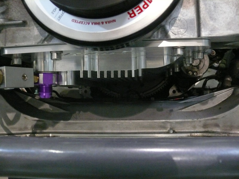

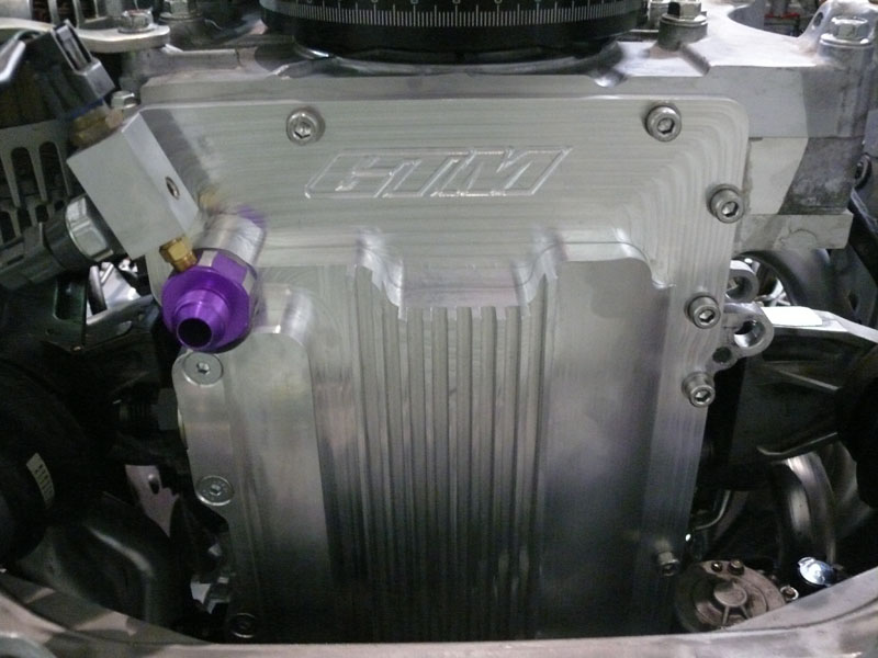

In order to spin the car up past 8000rpm more reliably as well as avoid any oil supply issues a dry sump was decided upon to lubricate the motor. I looked into the existing Dailey's Engineering kit and was going to purchase it until i got the final price and broke out in a cold sweat, since the pan and pump was $7000, needed a custom solid aluminum motor mount, and there was like $10k additional in parts to get the pump to fit with the accessories and actually make the system work. After talking to Sam I decided to let GTM develop a new cost effective solution to this problem and he came through with a Billet oil pan, Peterson Fluid Systems R4 4-stage drysump pump, and peterson tanks,breathers, filters. In order to keep the costs down it was decided to make a billet bracket to replace the air conditioning with the pump and make the pan so that lines could be run to it. The A/c can be reinstalled down the road by using the GTM Bracket kit to move the alternator and power steering up and mounting the pump on the passenger side but for now I decided to save a couple grand and drop the weight of the a/c system. Oil capacity is now 12.5 quarts and I need to install a smaller cooler in the system as my oil temps have not gone over 190 since the system was installed. The kit also uses a high capacity racing oil filter and light wieght synthetic braided AN line for the low pressure side and stainless on the pressure line for safety. A peterson Vacuum regulator and new breather set up had to be fabricated to control the engine vacuum generated by the massive new oil pump down to 14"Hg. The vacuum pulled by this pump eliminated windage and gave us a nice Hp gain as well. To drive the pump, an adapter was made to reuse the factory crank pulley, but since I had saved money on the system I opted to go for the full ATI underdrive super damper setup Sam has to help out with high rpm crank vibration as well.
