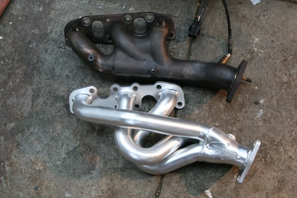

"Shorty" or short tube headers. For reference:
I have been researching this for a while. I know of the Stillen and the AMS motorsports, which look very similar but much cheaper. Also the Z1 headers but these will only bolt on to pipes or HFCs made for the VQ35DE engine, so you will have to swap out your cats, which is something that you don't want.

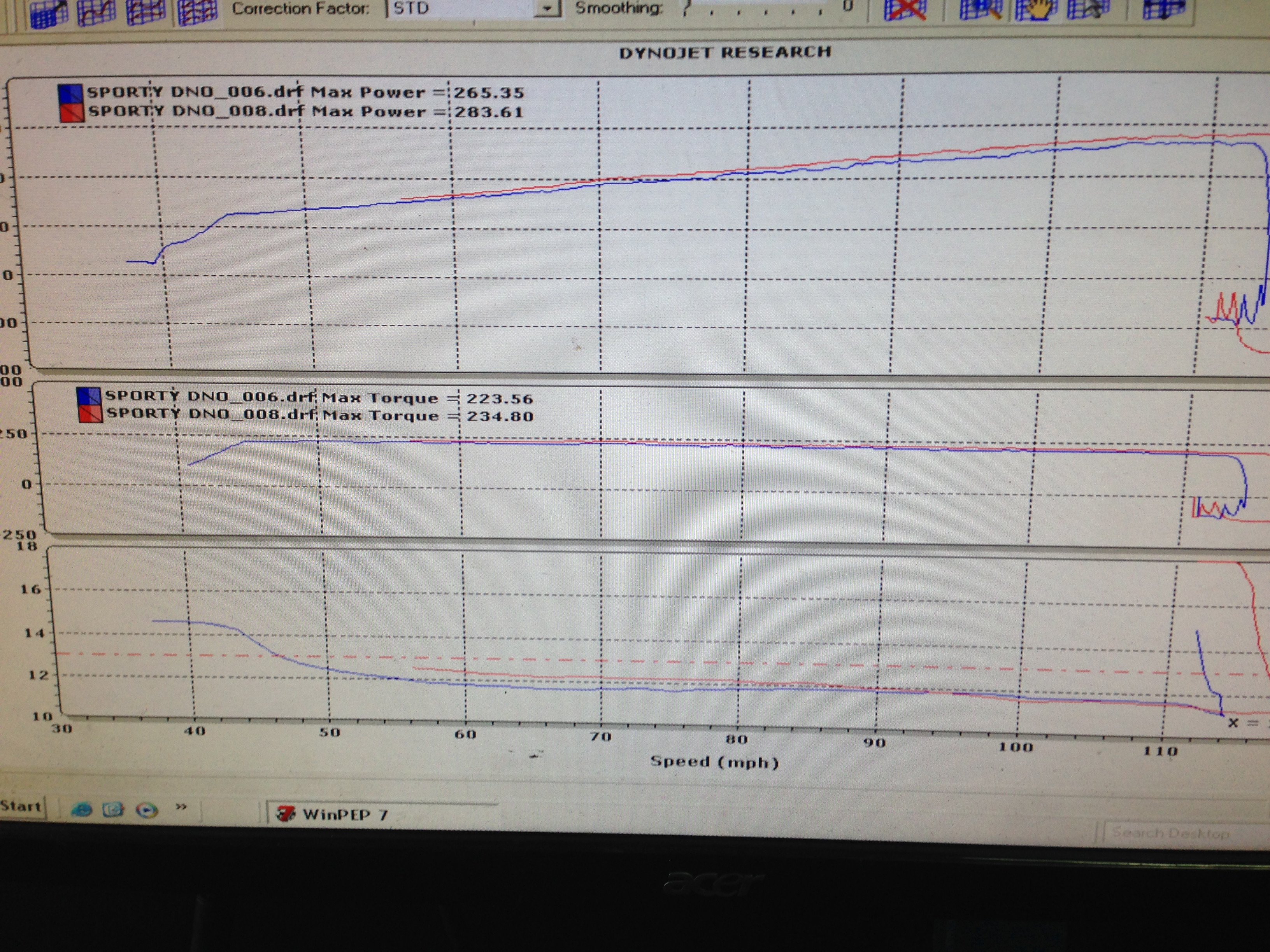

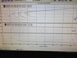

I had great results with knockoff LTH.
Headers are NOT the most significant power adder, catless is.

Originally Posted by Synolimit
I had great results with knockoff LTH. Headers are NOT the most significant power adder, catless is.
This is just the FI RHFC. Yes, it is a low reading dyno.
