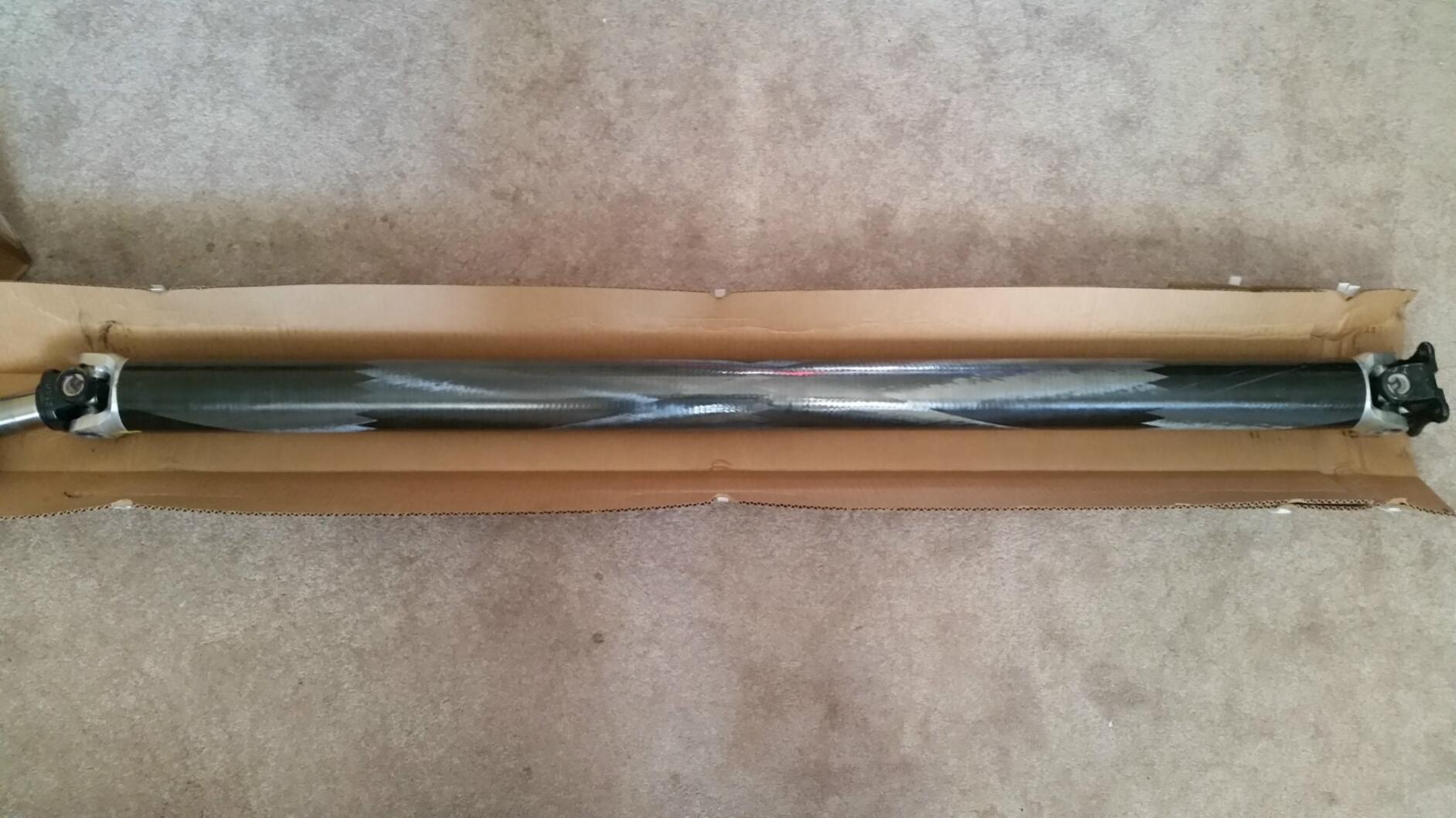

Ordered Tuesday afternoon came in today!! $h!+ just got real!

That looks awesome. Can't wait to see the results. Looks like I found another mod to add to my list
Do you have any current dyno numbers on your car?

Carbon Driveshaft installed, went inside to change clothes to go work out and do some 0-60 logs and when I came back out it was pouring rain. During the install I switched back to the 6mt flange and the most obvious characteristic that jumped out at me was the lack of vibration. I "thought" I didn't have vibration using the three point flange but now that I have a truly centered driveshaft I realize that there was a slight shudder at speed that is gone with the PST shaft. If it's dry tomorrow I will be doing 0-60 Cipher logs to see if the driveshaft truly improves acceleration. If anyone else plans this route the measurement for the driveshaft using a 7at mated to a 6mt with the 6mt flange is 61 5/8". FedEx didn't bring my M370 today so that's a good thing because I would have installed it and skewed the results. Hopefully I'll be adding the M370 and the resonated xyz tomorrow as well as testing and tuning for the 1/4 Friday night.

I'm a bit lost. The vibration came from where? Switching from your OEM 7AT to the 6MT flange?
