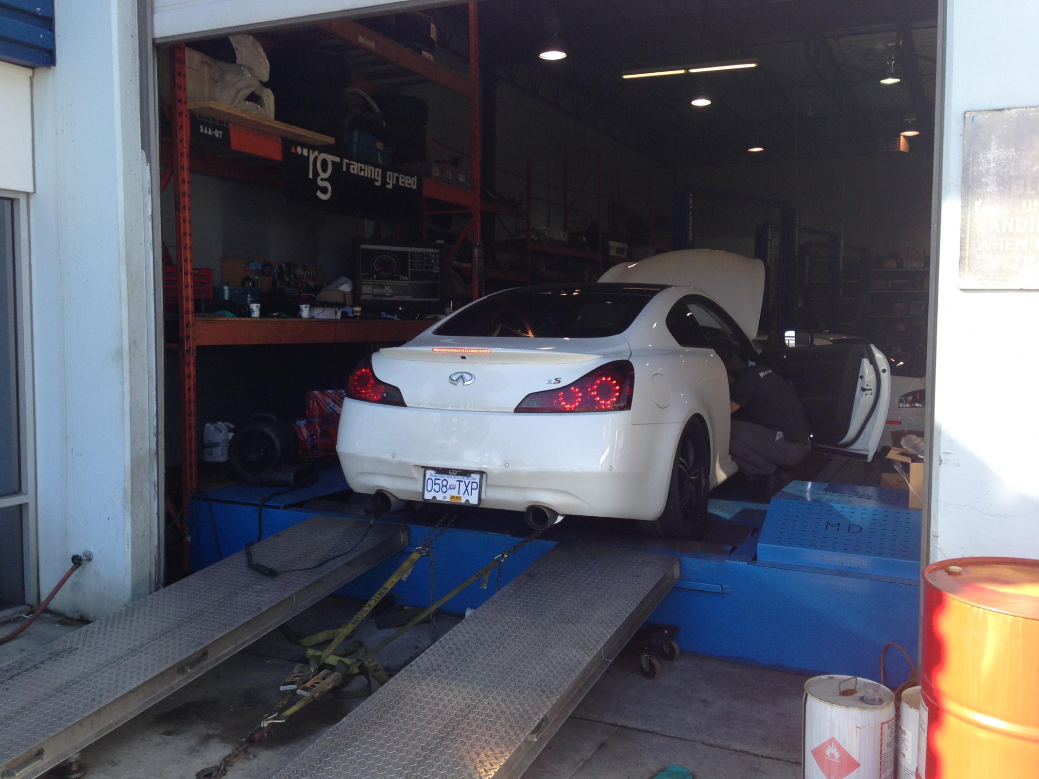

-Wheel Horsepower rating of 475 and Torque rating of 367 (Dynojet)
