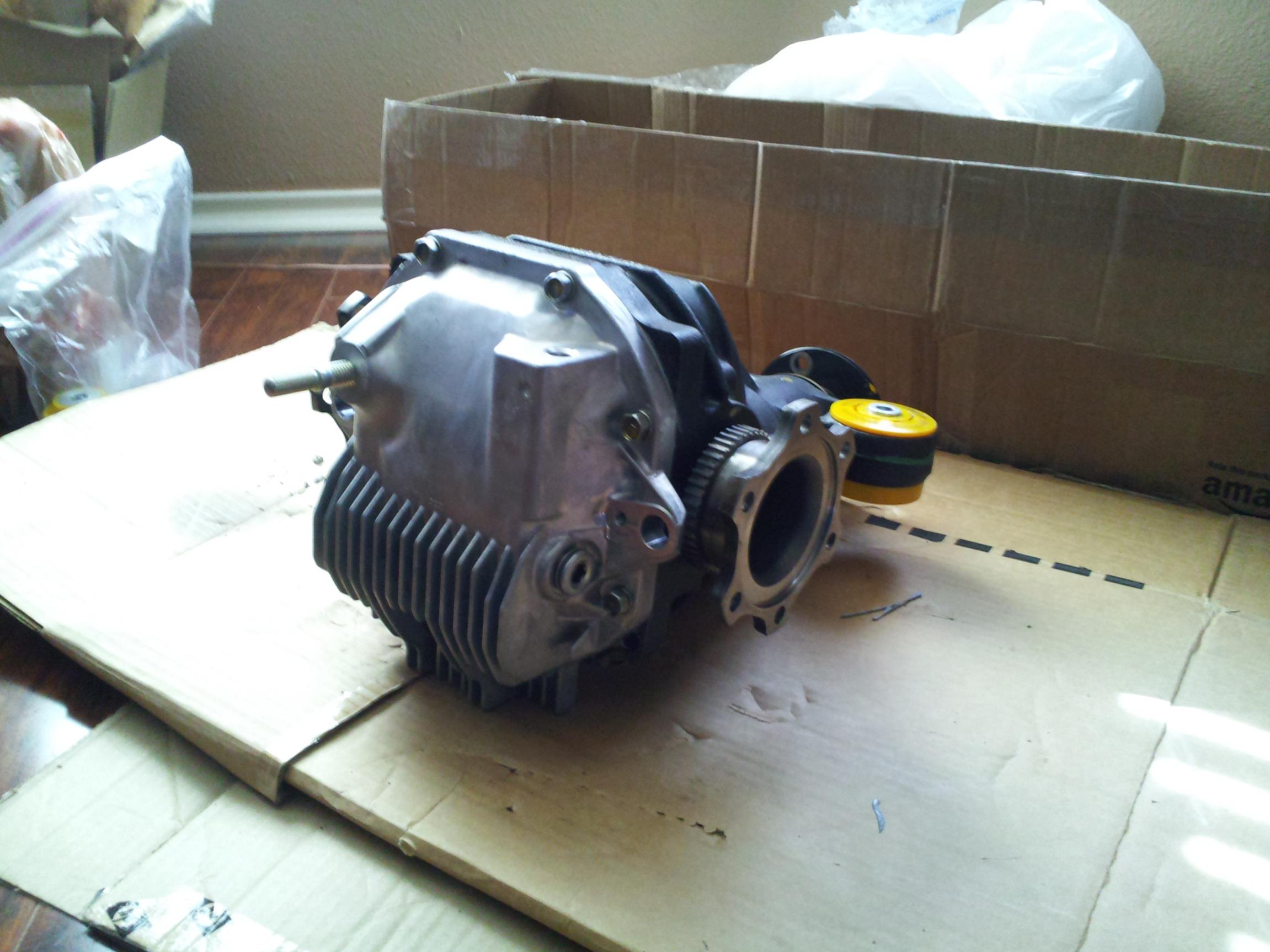

Have to give props to SharpByCoop and ivoidwarranties (Jim and Kevin). Thought long and hard about doing this after swearing I wasn't going to do anything else to the G for a good while. Ok, a few months maybe. Followed their threads since both had 08 5ATs like me and suddenly the lightbulb burned bright. Damn -- had to do it! I bought Kevin's 6MT 4.08 VLSD and rear portion of the 6MT driveshaft. Bolted right in. The 3.69 diff is sitting in the garage having a pity party. Performance of the 4.08 gear ratio? Pure sex! It's like the G popped Viagra.....schwing! Again, thanks guys!

Old Sep 4, 2014 | 08:32 PM
Solidus's Avatar
Solidus
Joined: Jan 2014
Posts: 266
Likes: 39
Dang, I'm happy for you. All my stuff is still camouflaged throughout the house. I need to set a hard install date so that I'm in time for a nice cool first time at the track. More on just how it felt.
