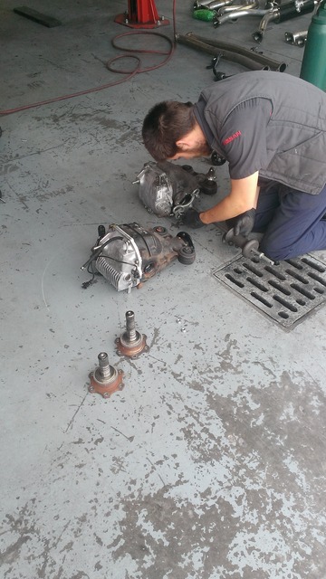

[QUOTE=chuckie311;4019052]It will not bolt right in You will have to change out the flange and more than likely the axle flanges as well. All of mine had to be change out because the axle side on the auto were threaded and the Manuel's were not[/QUOTe
I do believe the 08 diff will bolt in directly to the driveshaft for that specific year and I ordered threaded bolts from Nissan to address the threading issue that you succinctly pointed out....I think I have all bases covered but you never know until you get under the car and tear everything out....
Old Apr 18, 2016 | 01:40 PM
  #32
chuckie311's Avatar
chuckie311
Drop A Gear and Disappear
Joined: Jan 2011
Posts: 2,449
Likes: 194
From: Las Vegas
it will not i bought mine from from a 08 as well .... i had to change the flange on the drive shaft and the side flanges as well
here they are being changed out
Old Apr 18, 2016 | 06:00 PM
  #33
oakroadsteve's Avatar
oakroadsteve
Joined: Jul 2015
Posts: 31
Thanks for the heads up Chuck..I assume you swapped the side flanges off the diff that was on the car, the 3.36 flanges. Where did you get the flange for the driveshaft??
Old Apr 19, 2016 | 08:53 PM
  #34
oakroadsteve
Joined: Jul 2015
Posts: 31
The flange on the 08 diff I picked up is the triangle 3 bolt unit and should match up to the driveshaft...I have the threaded bolts on order from Nissan that should bolt up without swapping...
I am getting conflicting thoughts on the axle boltup and sure would like to minimize any unexpected obstacles.
