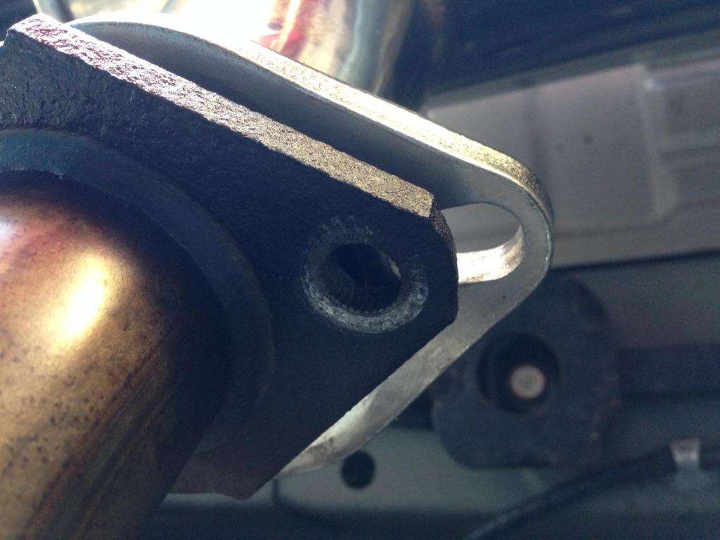

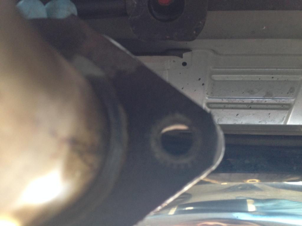

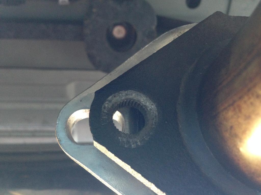

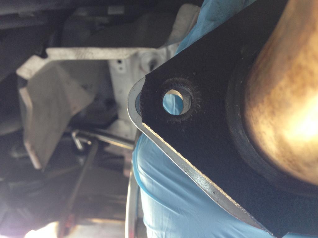

I have given up on megan's customer service, they are always asking for me to take pictures and send it to them. I will never buy a megan product ever again. I wish i knew about the fitment or else i would have spent the extra money for the tanabe axel-back.
PS: I went to ace hardware to buy smaller bolts and I still have an exhaust leak (Im using two gaskets as well, the OEM and the megan gasket), The smaller bolts did actually help but the exhaust is still misaligned from the OEM mid pipes.

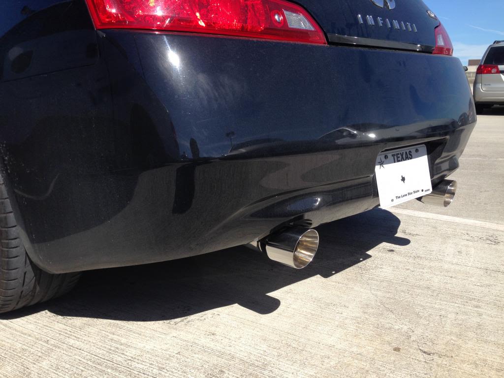

Removed the Titanium Burnt Tip along with the ugly Megan Logo (All I did was take 1000, 1200, 2000 grit sandpaper and wetsand than i took my mothers powerball along with mothers mag & aluminum polish and buffed it to a polish finish) It looks 100 times better
