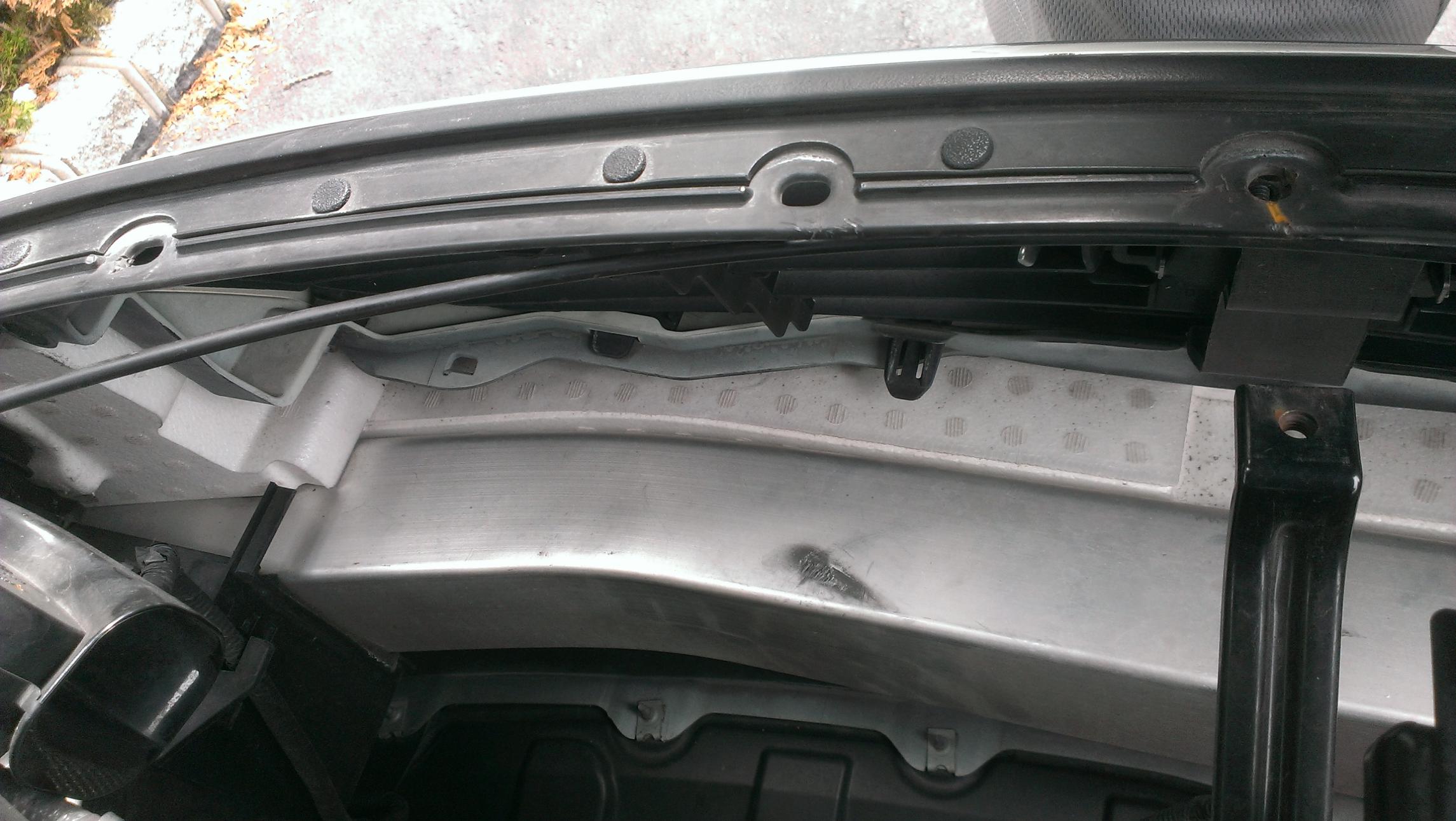

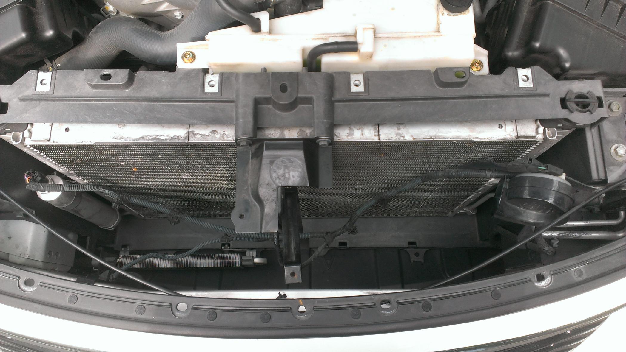

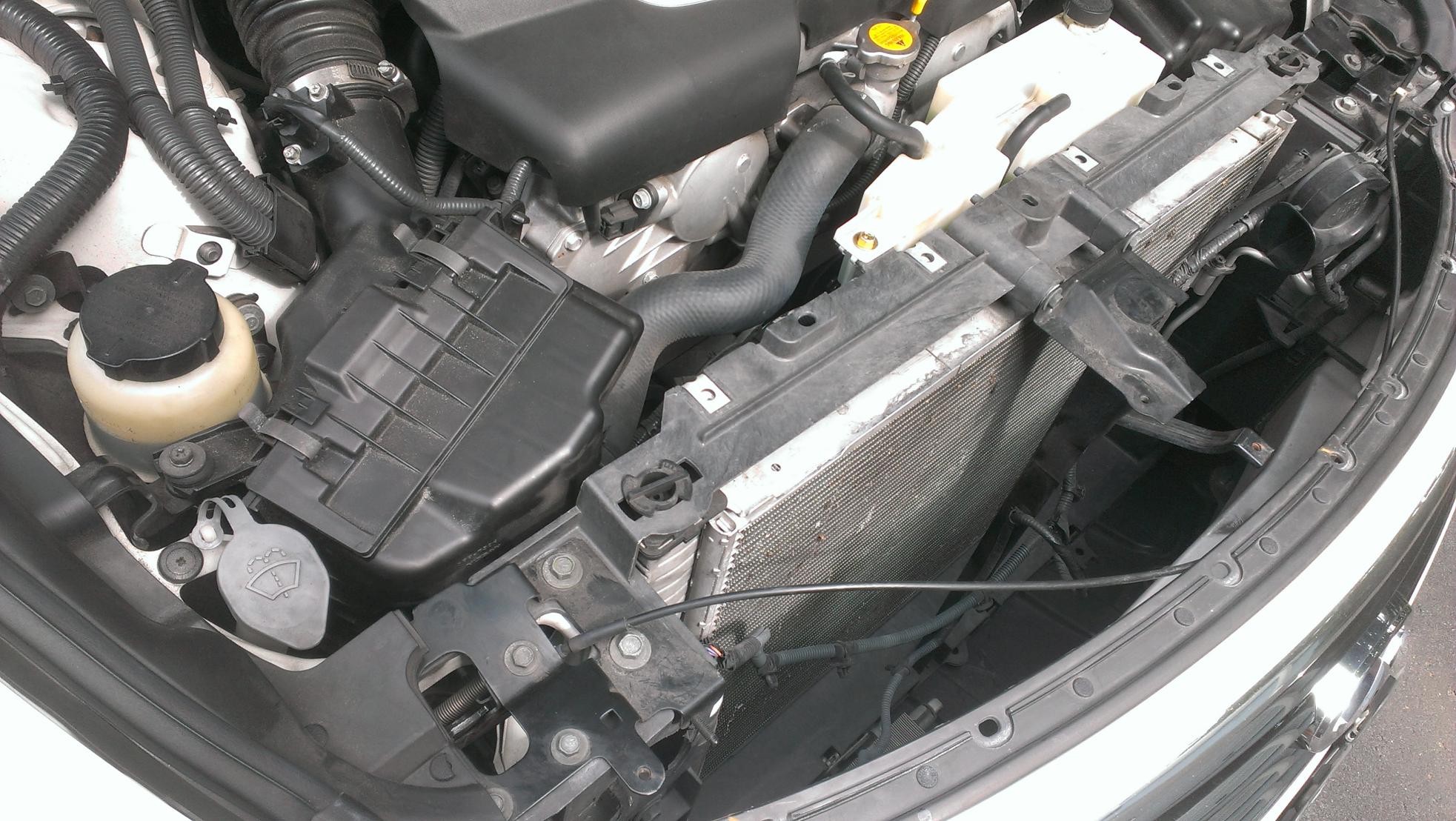

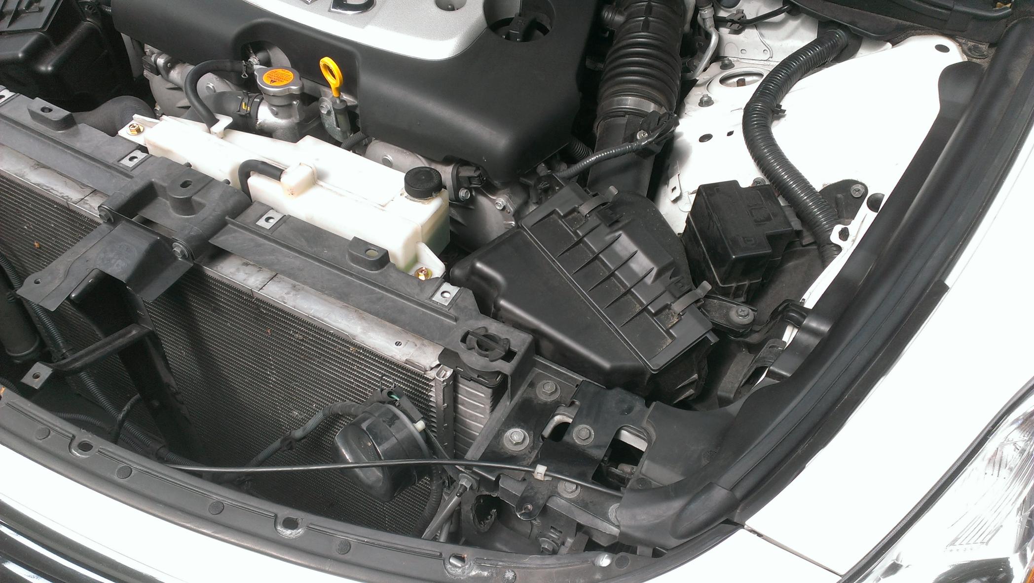

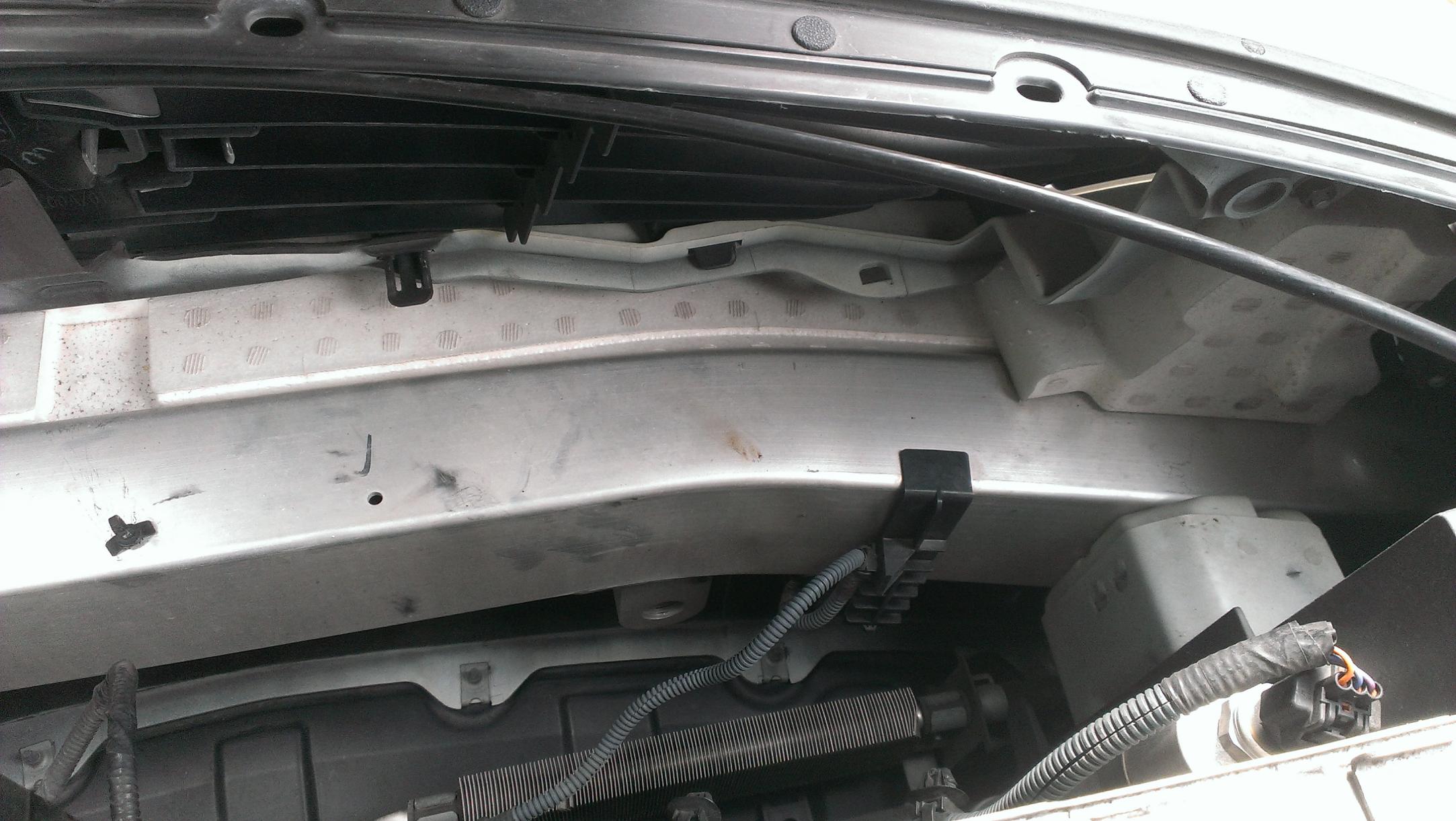

So i just bought an 08 g37s coupe/journey with about 38,000 miles...I believe i got a good price for it and it had a clean carfax however after I had couple friends look at it and seeing the pics on this forum, we noticed that he had few parts missing in the front...it seems like it was in an accident. Seems like the engine wasn't affected but the bumper does seem a little loose (might be because the cover is not attached).
Anyway, the main thing we noticed that was missing was the radiator cover...is this important? Not sure how long its been ridden like this...should I be worried?
PS. does any1 know where I can buy 1 and all the necessary bolts, etc.?

Welcome to the forum. Please post pictures of what's missing. Yes , the radiator shroud is important for cooling. You can buy it from a dealership or buy one at a salvage yard.

Thanks Black Betty....Attached are some pics from the front and side...i will attach two others of the back of the bumper...maybe some1 can tell if its the oem bumper or if it was replaced.

here are the other pics
Attached Thumbnails Bought Used G37....Missing parts :(-inside-of-bumper.jpg   Bought Used G37....Missing parts :(-inside-of-bumper2.jpg   Bought Used G37....Missing parts :(-imag2335.jpg

Here's a copy of my reply on the grill removal thread~
Originally Posted by MIBeta86
Hey everyone, just signed up...seems like a great community and an abundance of information here from I've read so far...
Anyway, the main thing we noticed that was missing was the radiator cover ....I see everyone had difficulties taking it off but was it easy putting it on?...not sure if I should do it myself as I'm a newbie in any car related work and probably dont have all the right tools.... Should I do this myself?
It's an easy install, just have to get all the wiring clips snapped in prior to the final fit of the cover. You need to get it all together and then get it flat where it needs to be and give it a firm push back toward the engine to clear those two hidden plastic pins, push it down over those pins and you're good to go. Here's a source for the shield, it's part # 6 in the diagram and a bit over $50. Welcome to the site BTW, and congrats on your new G!

This is great info. Now i just need the right clips and pieces needed for the cover to go on.
Thanks a lot!

Check the wiring wrap behind the grill, they probably still have the clips on it along w/ the hood opener cable.
