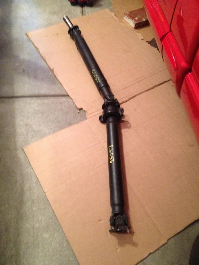

Finally got my hands on a driveshaft from a manual (only used the rear half).

I used the rear half of the manual drive shaft and the front half of my auto drive shaft and put the new 4.08 diff in. It fit perfect.

To the users who may not have followed our other thread on this conversion: THe 4.08's HAVE to be installed in a MT VLSD diff housing from any year G35/G37/350Z/370Z.
With the auto trans you NEED to use a manual transmission back half from a 2007+ G35 or G37. The 4.08 gearset pinion does not have that finger which aligns and centers the AT rubber coupling.
^^^ This is the best method.
I also did the conversion in my 5AT, and BOY is it responsive. Just like he said: It makes it right.
