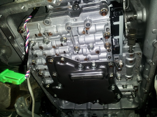

Just follow the detailed instructions, drain the oil in a clean 2 gal bucket and remove the oil pan. The instructions tell you what bolts to undo to remove the valve body and the instructions even show the different lengths of the various bolts and where they go. Unplug 2 sets of wires and you are done. About a 2 hour job.

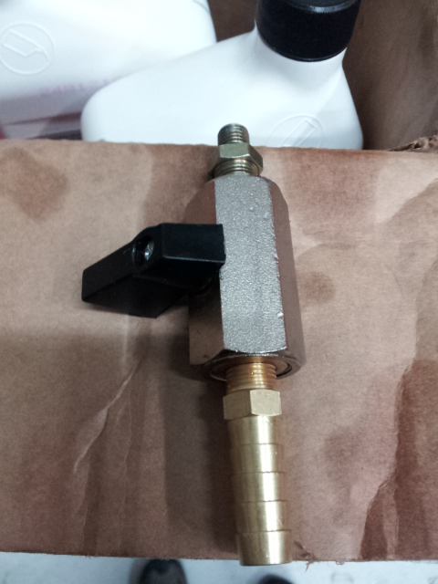

Buy a new pan gasket cost is about $40. To refill fill the transmission first calculate how much oil came out plus a few quarts extra. Buy a $13.00 hand pump from any automotive store. You will need to fabricate a fitting to screw into the refill port on the bottom of the oil pan opposite the drain plug. I did this at a cost of $12.

Here is the fitting info for anyone wanting to make their own filler adapter.
You will need
(1) 1/8" male npt to 8mm x 1.0 male adapter
(1) 1/8" npt female to female ball valve
(1) 1/8" npt male hose barb fitting
You can get everything from your local hydralic hose warehouse.
