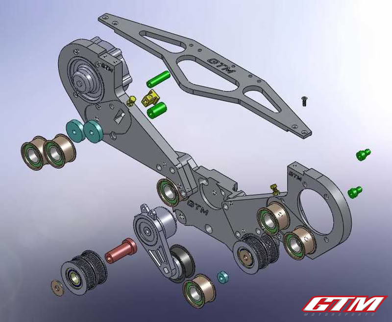

Here’s a sneak peek at the design drawings of our Twin Supercharger system layout:

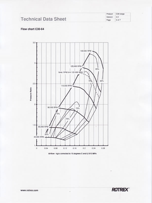

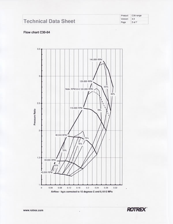

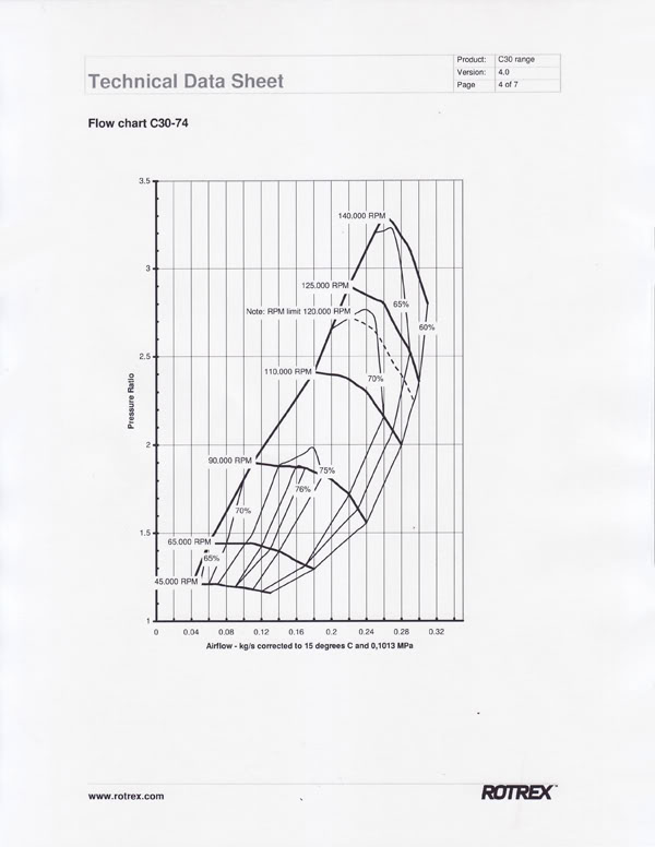

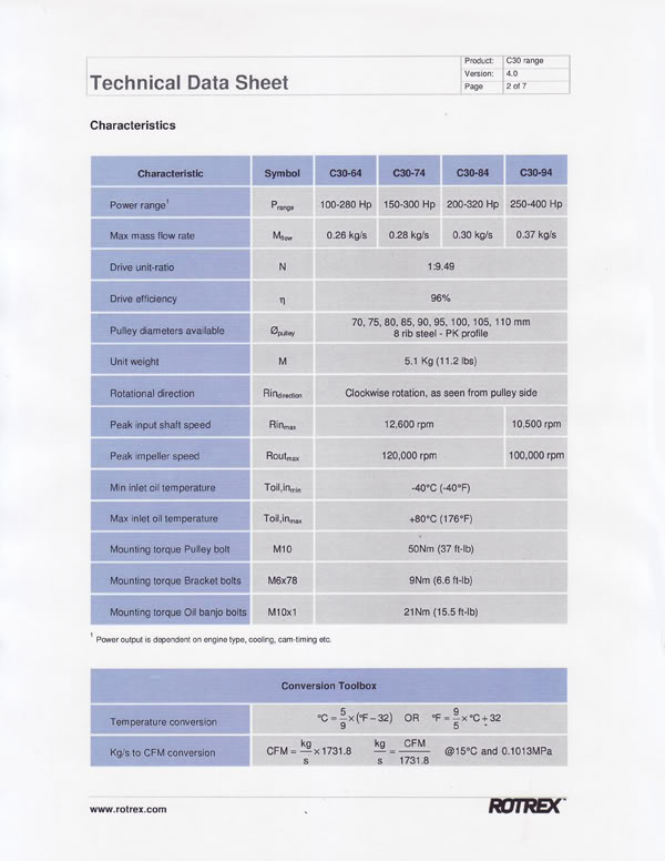

Here is some information from Rotrex’s website:

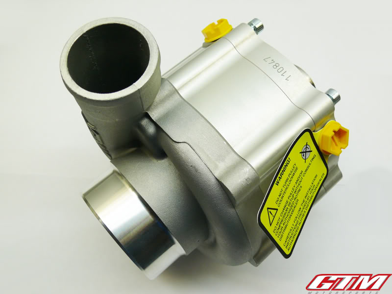

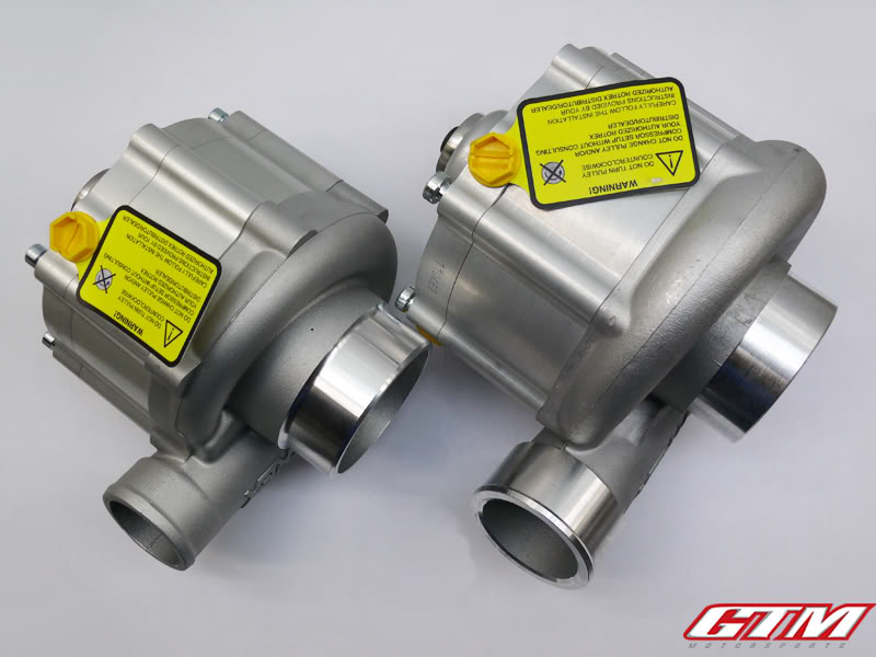

Here is a side by side picture comparison of the C38 (used in our current supercharger offerings) and the smaller C30 supercharger unit.
