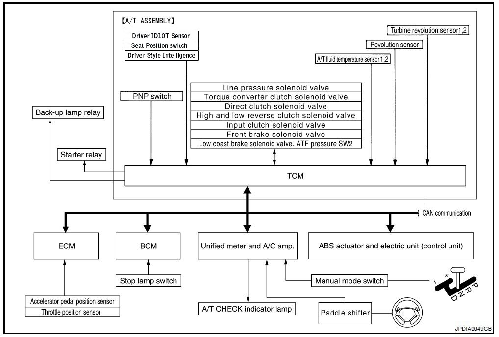

Originally Posted by FishMeetFish
Another question is, does the car have separate learning for driver 1 and driver 2?
Let say I'm driver 1, wife is driver 2. Say the wife drive like a turtle and I drive like there is no tomorrow. Does the car get confused? Or the car is smart enough to know there are 2 drivers are react to each separately? After all, we each carry a different key.
Why yes, that's exactly how it works. It doesn't get confused since the seat switch is part of the driver ID10T logic. Note, not all G's have this capability though.. You have to BELIEVE it to make it real. Don't take this personally, just in the mood for comedy.
Thanks for the info. So the ID1OT logic take care of the confusion.

Yep, one other tidbit of note, the accelerator pedal has two sensors, one to monitor position, the other to monitor speed of change in position.
Can't they derive the speed of change in position from the position sensor? Simple mathematics. Then why 2 sensors? I don't get it. Is it because I understand their ID1OT logic?
Yes it's ID10T logic, however my own this time. I missread the docs, it looked from the graph that one was used for position, the other for speed. Looks like they both measure position and speed. Just relaying since that's all you basically have to communicate with the transmission, how far you push it in addition to and how fast you got there.
The accelerator pedal position sensor is installed on the upper end of the accelerator pedal assembly. The sensor detects the accelerator position and sends a signal to the ECM.
The Accelerator pedal position sensor has two sensors. These sensors are a kind of potentiometers which transform the accelerator pedal position into output voltage, and emit the voltage signal to the ECM. In addition, these sensors detect the opening and closing speed of the accelerator pedal and feed the voltage signals to the ECM. The ECM judges the current opening angle of the accelerator pedal from these signals and controls the throttle control motor based on these signals. Idle position of the accelerator pedal is determined by the ECM receiving the signal from the accelerator pedal position sensor. The ECM uses this signal for the engine operation such as fuel cut.
