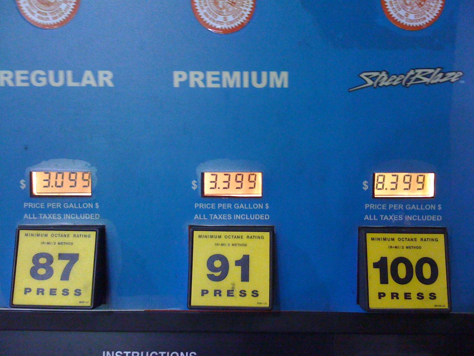

High Octane @ the Pump. So Temping...
Thoughts?
100 Octane at the pump? Think there is a danger here without tuning for it?

prolly not

there is no point of getting it, unless the car is tuned for it

For $8.39 a gallon I'd say hell no.

You lucky bastard! It's safe to run a higher octane without a tune. Some people have proven gains with it too. I just don't foresee the cost difference weighing the few extra ponies.

Want me to send you a few cans? haha
I agree with you guys, way too expensive. Maybe worth it with an intake (or more and at tune) if you wanted to speed around or maybe have a track day, but otherwise, it is way too pricey.
My new business - Send me your gas can and your cash and I will ship it back full. lol

Specifically, octane higher than 91 for our G’s does nothing but waste money. It does not offer more performance or power because the 91 octane requirement is to prevent knocking for our engines, that’s all.
Look in up. Read the manual. Do a search (try “higher octane” and you’ll get 68 threads on the subject). Google it. Putting in anything higher than 91 will do no more than opening a window and shouting, “Vroom, vroom” would do.

Go ahead and run the 100 octane. Just telling your friends you run it will put you in that "special" crowd and all will know you will then be way faster, get better mileage and will be so cool mixing your gas in front of everyone and bragging about how much better your car runs with it when they all will actually be laughing behind your back....

Won't be doing anything but spending money. The higher the octane the more heat and pressure it can take before it detonates(ignites without a spark) so if you tune for 100 you are not getting anything from the higher octane you are getting more power because the use of higher octane is facilitating your tunning to advance your timming beyond what you could run on 91 or 93 without detonation.
Same thing as nitrous. The nitrous itself does not add power. If you were to inject nitrous into your intake without adding additional fuel there would be no gains and you would probably lean out to a point of destroying your motor. The nitrous is simply fake air that allows you to add more fuel which gives you more power.
